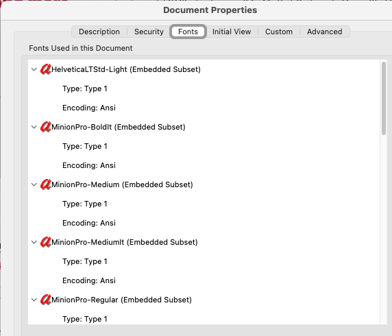

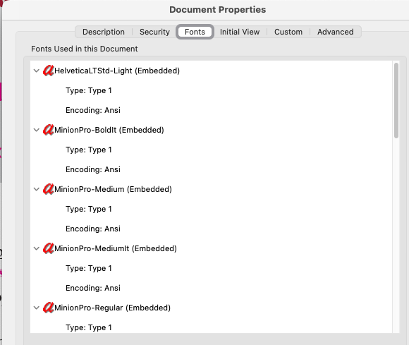

My computer will not embed fonts into a pdf when using version 18.1 or 18.2.  If I roll back to 18.0 the fonts embed again.  No other settings or presets changed.   Did Adobe remove the ability to embed fonts in 18.1?
I attached pdf info of the same pdf generated with 18.0 vs 18.1.

Everything in the pdf looks fine and they print fine.   Our creative team generates the pdfs and passes them onto programmers working with software called GMC Inspire.   The pdfs have variable fields that get data merged from within the GMC software.   GMC needs to have the fonts fully embedded in the pdfs to function correctly, otherwise the programmers need to load the fonts onto their machines for every job.   Also dealing with a MAC to PC workflow.   We eliminated all of the postscript fonts from our systems, but I don't think all Type-1 were removed.

Ok, so the files are still embedded. Just not fully embedded. So they will display and print fine. If you want t to take this problem first be sure to say you want t "FULLY embedded".

Both screenshots shown embedded fonts. It says so.

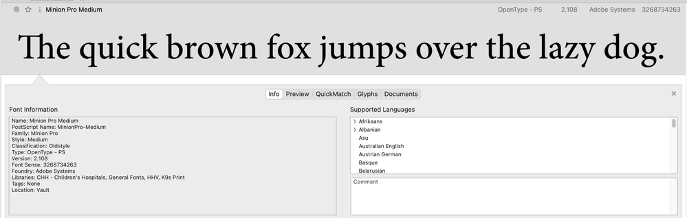

Almost all of our fonts are listed as OpenType - PS in our font software Connect Fonts.   Are none of these OpenType - PS fonts supported anymore?   Looks like the Adobe Fonts are also listed as OpenType - PS.

Sorry, I was pretty disracted this morning and didn't really look closely enough at the screen captures. Those are, indeed, OpenType fonts (with postscript outlines) and are fully supported.
As Aandi noted below, the fonts are embedded, but they are being subsetted contrary to your settings. I think that's probably a bug and should be reported. I beleive this is still the correct link to do that: https://www.adobe.com/products/wishform.html
