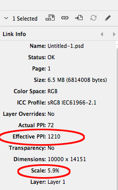

Your 10,000 pixel image at 72ppi would have an output dimension width of 138.88 inches. You would have to scale it down to 6% in order for it to fit an A4 page, and the scaled output Effective resolution would be 1210 PPI
Keep in mind when you export to PDF, most PDF print presets will sample down images over 450ppi to 300ppi, so unless you change the default preset Compression setting, the 1210ppi image will get significantly down sampled on export
