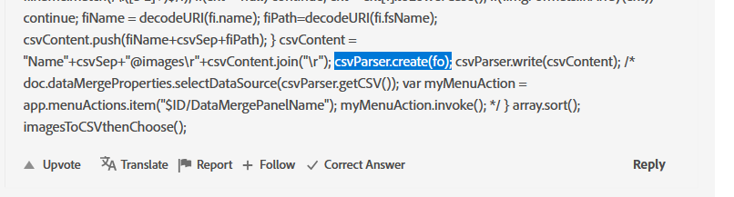

Copy link to clipboard
Copied
Before marked part:
RobertatIDTasker_0-1730508025351.pngexpand image
csvContent.sort();
So you should have something like this:
csvContent = "Name"+csvSep+"@images\r"+csvContent.join("\r"); csvContent.sort(); csvParser.create(fo);
Votes

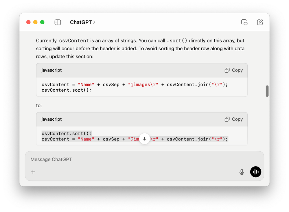

Enthusiast ,
Nov 05, 2024 Nov 05, 2024
Copied
Robert
thanks very much. You were close but I kept getting a javascript error. So I ran it through ChatGPT and it gave me the correct answer, and now I get a csv file that's already sorted.
