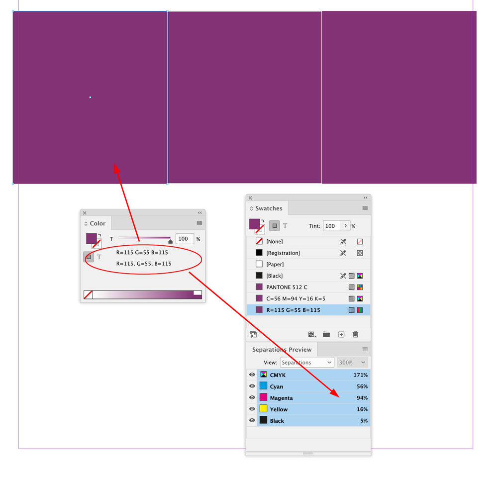

Hi @sd5e8a , Also, as Jeffery suggested Lab is device independent, so its appearance doesn’t change if you change the document’s RGB or CMYK profiles. Custom ink Spot color libraries are usually defined as Lab because a custom solid ink isn’t a process CMYK color and wouldn’t change in appearance depending on the presses’ CMYK profile.
A Lab color is converted directly into your operating system’s Monitor profile for display, and if a Lab spot color is converted into CMYK for a process color simulation, the conversion is directly from the Lab color to the destination CMYK profile.
You can see that here where my document’s assigned profiles are AdobeRGB and Coated GRACoL. The swatch in the middle is Pantone 512 C Lab, the swatch on the left was converted into document RGB (Adobe RGB), and the swatch on the right was converted to document CMYK (Coated GRACoL). InDesign lets you mix color spaces on the same page, and Pantone 512 is inside of both the AdobeRGB and GRACoL CMYK color gamuts, so the color appearances are identical. Also if I turn on Separation Preview the CMYK output values (an export to document CMYK) are identical:

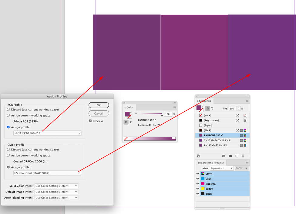

If I change the document profile assignments, the RGB and CMYK colors change in appearance, but the Pantone Lab color is unchanged. Here we can see the expected color change when the Coated GRACoL CMYK conversion of Pantone 512 Coated is put on a press printing to the US Newsprint (SNAP) standard:
