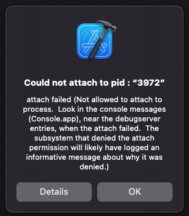

Jun 07, 2023 Jun 07, 2023
Could you tell me what I have to pay attention when I want to debug the release version?
Because the only thing I did was simply activate this checkbox, but unfortunately the only time I was able to debug with the release version was with an imac (intel) using indesign 2019 and I only succeeded with that version with all the others no, because it gave me the same error that it gives me now on mac Studio.
I doubt that the problem is the pc I use, I'm probably ignoring something that's doesn't allow the correct functioning, but I don't know what.
I leave these two screenshots for you to understand better the possible problem.Schermata 2023-06-07 alle 10.13.00.png
Stefano
