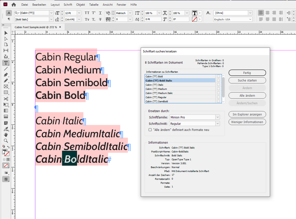

There's also a strange behavior of InDesign 2021 when I provide the OTF variants through a Document Fonts folder to the missing TTF fonts used in the sample InDesign document. The fonts are flagged as missing in the layout and selected text will show the name in brackets like that:
The Find Fonts panel will not flag the fonts as missing.
Also InDesign's preflight will not do this.
And now the interesting part: InDesign's PDF Export (Print) will show missing fonts:
I think, this is a severe bug with InDesign's internal font management and the Document Fonts folder.
FWIW: This has nothing to do with the case of using the variable type of the Cabin fonts; I only post this to show that it is not possible to substitute fonts with the Find Fonts panel in this case.* And InDesign's Preflight will not discover the issue!

Feb 11, 2021 Feb 11, 2021
OK. Had to correct my post above. Tried to substitute the missing TTF fonts with OTF using the Find Fonts panel and this worked:

Feb 12, 2021 Feb 12, 2021
"Interesting that InDesign can see the difference between the TTF and OTF."
With mixed results:
Preflight will not notice it: Bug.
Find Font will not notice it. Instead it is showing the used TTF fonts as OTF fonts as my first screenshot in Info is showing: Bug.
PDF Export (Print) finally sees it. That's OK.
