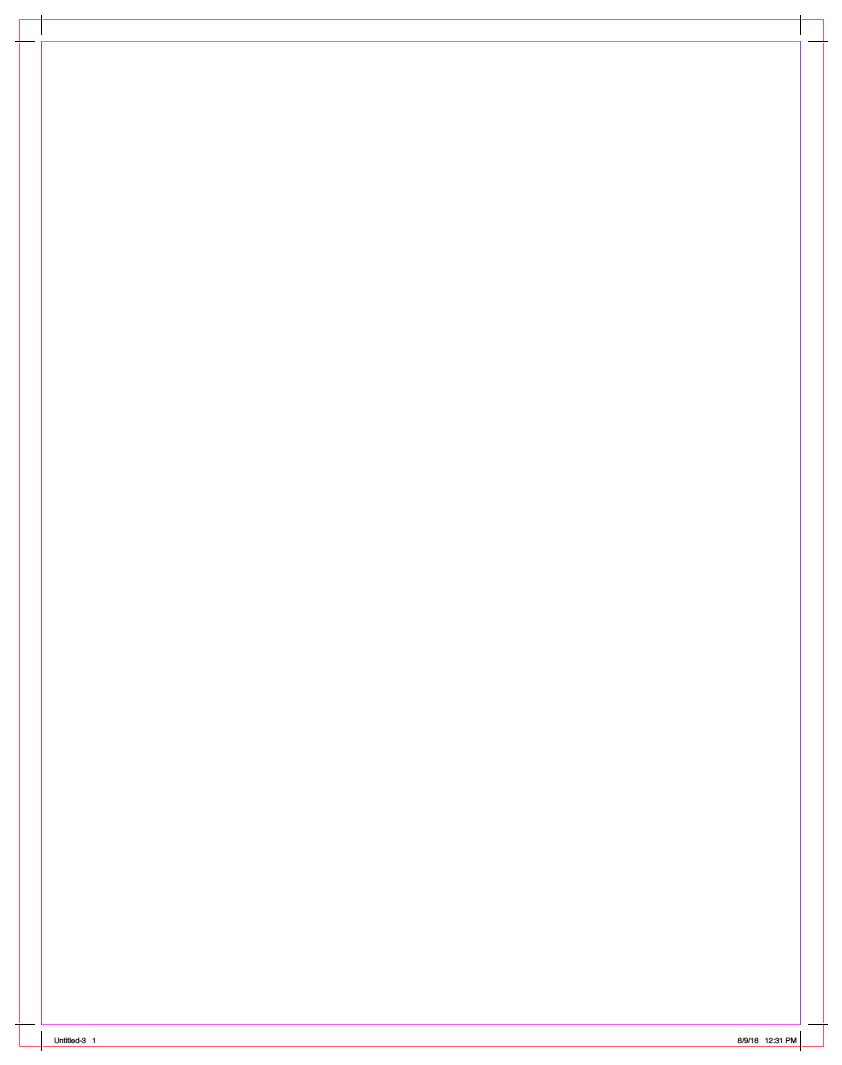

    File>Export... will bring up the Export dialog window. At the bottom of that choose Adobe PDF (Print). After you choose your save to destination and click on "Save" the Export Adobe PDF dialog will appear.
    The way that I suggested to do this in my first post will look like this:
    The outer red line is the bleed.

    Every screen shot here is showing the trim marks intruding into the bleed, this is not good, the trim marks should be offset beyond the bleed size, as shown here.

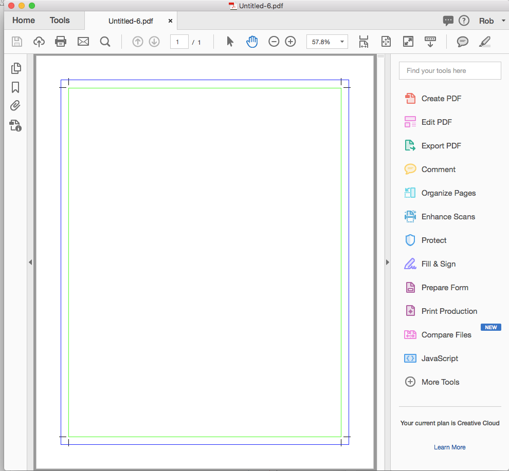

    Actually, Derek, I think that the printer may actually want the bleed lines (I've had this request). See screen shot:
    Make sure that the Document Bleed has been set in the Document Setup dialog window (first picture) and "Use Document Bleed Settings" is checked in the Marks and Bleeds section of the Export Adobe PDF window (not shown here) and that "Visible Guides and Grids is checked in the General section of the Export Adobe PDF window (second picture).
