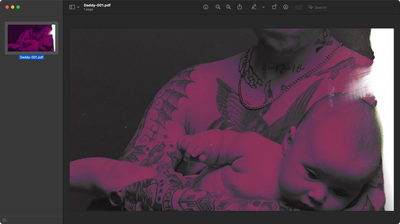

The export looks like this in MAC PREVIEW (weirdly, the thumbnail looks OK)

Preview is garbage! It has always been garbage!
You are exporting an Adobe PDF. Outside of Acrobat or Reader, there's no way to know what you're going to get.

True, but thisis the first time I've had such a disconnect between a working doc and the output in preview. And it's all within the RGB space, no desire to print anything. How can I minimise this difference?
Nov 10, 2023 Nov 10, 2023
You could try flattening any transparency but that's probably going to litter it with stitching. Sorry, but beyond using PDF/X-4 I can't help troubleshooting Preview. How does it look in a browser?

Exporting with Acrobat 4 compatibility does the trick! However, this just works as a print PDF and I lose all my hyperlinks in the doc. I imagine color conversion is not available in Acrobat 5 and above?
Perhaps I'm better off creating the images (with color overlays, film grain etc) in Photoshop and keep the Indesign project simple.  Unless I'm missing something here.

Acrobat 5 and higher keeps the transparency effect live (the color can still be converted) the print driver has to handle the flattening. If you are Exporting to Interactive all color gets converted to sRGB, but transparency effects do not get flattened. You could try flattening with AcrobatPro-- see print tools.
