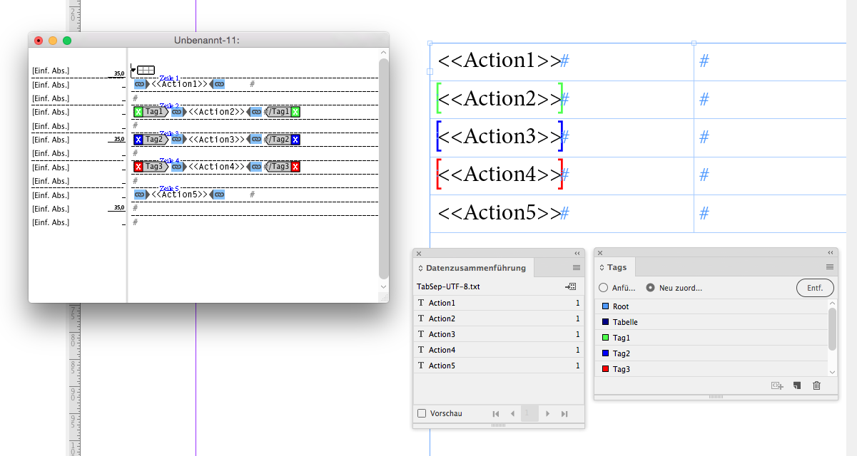

Colored brackets like the one in my made-up example below.
Open your Story Editor window and see if you can find something like that:
If the XML is not necessary I would remove it from the InDesign template document.

My <<Action 1>> does not have any brackets, because I saw in one of your screenshots, that your <<Action 1>> is missing the brackets as well. Just wanted to simulate the view you gave to me with my InDesign by applying XML tags. They have no meaning at all.
