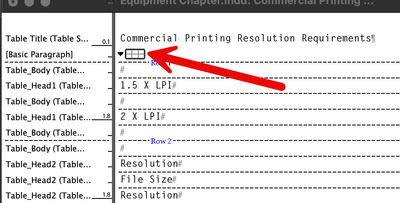

I'm trying to understand the formatting of some docs I've inherited, and I'm new to InDesign.
I don't understand what I'm dealing with in the attached screen shot. There appear to be three columns, but the text frame has only one. The area(s) containing the text are part of the text frame (they disappear when the text frame is hidden or deleted), but can't be selected in the layer view.
And, as you can see, the mystery area exists outside the text frame itself. What might this be?
Note: The other objects in the layer list are on a facing page, out of view.

I think that it is a table.
LEGEND , Apr 03, 2025 Apr 03, 2025
@Thomas_Calvin
It's a Table.

Something in an underlying text frame, or another (possibly locked) layer?
Not being able to select it is odd. OP might try tabbing/arrowing over from the accessible columns to see.

Thanks guys. It is most likely a table, and I can tab between the columns. But it does not appear as an entity in the layer list; there are no other layers in the doc aside from what's depicted.
Where would the table properties be shown?
Start by dragging the text frame wider for access to those columns.
Then select the table full width, and drag the right margin in to a net width better suited to your text frame size.
All controls are in the Table palette and/or Table menu.

Thanks. I had made the frame smaller to show how the mystery area overflowed it. Even with it as big as possible, you can't select the table... except with another mystery thing; it has no ToolTip, does nothing when clicked, and produces no relevant context menu when right-clicked:
But when double-clicked, it turns the cursor into the row/column-selection arrow.
The question is why the table is not mentioned anywhere, and is missing from the Properties pane:

Looks like you're on a Master / Parent Page?
But you should still be able to edit it "as usual"?

You're right about the master page, but there wasn't any apparent way to select it or any indication that it was a table.
Click inside the frame with the Type tool--if you can't, Cntl/Cmd-Shift-click in the frame with the Selection tool.
The look at the Story Editor under the Edit menu. You can see any hidden text items there.

Table is a Character in the Text.
You need to select table and then you'll have some options in the top bar - or in the Context menu:
If part of the Table is outside of the TextFrame - and you don't have cursor in this table - or haven't selected Cell / Column / Row - you won't be able to click on this part.

Thanks. Even with the frame big enough to contain the table, you can't select it... even by clicking on a cell border. The only way is to guess that you have to double-click on the tiny, unlabeled "list"-looking icon on the left side to invoke table-selection mode.

Also the table is still missing from the Properties pane even if you have the text-insertion point sitting in it.

Because you've to have it selected:
If you have text cursor in the cell - or text selected in the cell - you're in the "text mode" - not the "table mode".

Unfortunately the means to select it are not apparent, because of the missing ToolTip.
Also, I would expect table-related controls to be revealed when you're working in a table. The Properties pane shows Character controls with no characters selected. Other applications (Word, for example) reveal table controls when the cursor is placed in a table with no text selected.

I had no way of knowing this was a table; therefore I would never have searched the help pages for information about tables. That's why the lack of the word "table" in the UI is such a critical problem, despite my spending quite a bit of time experimenting with the file before posting a question here.

Tables are text objects, not separate entities like a frame, so it won't show individually in the layers panel. It actually is contained in that text frame, but it's confusing because tables are not constained to stay within the frame boundaries.
