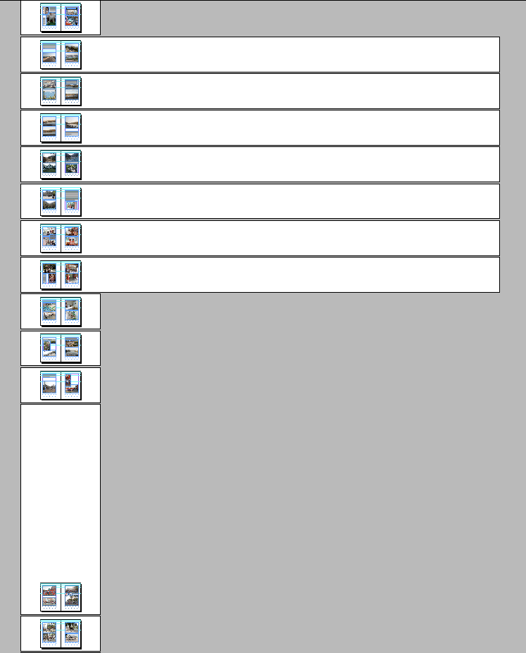

What in the world is this? - I had to minimize everything in order to see, where my pages went, when I scrolled down and they suddenly disappeared. As ypu can see, they didn't disappear, but when I now want to move objects, I get warnings.
What is this? How did it happen? And what can I do?
I have InDesign CS6.
In clear language:
Vad farao är detta? Monteringsbordet ser ut på olika sätt, och i de bred fälten varnas jag för att flytt objekt, för då kan de hamna utanför.

Looks like you have images wich has huge numbers for scale and position - no sure how this happened - probably you used some plugin or script which glitched...
You can select those images in the layers panel.

It's hard to tell for sure by the screenshot, but probably - there is something in pasteboard - maybe empty text box or something...
Can you share InDesign file?

What I have found: when I <select all> on a normal page, I'll see what has been selected. When I do it on these strange pages, it seems that something gar, far aside also is selected. But there is nothing.

With this help of yours I could identify some layers on each couple of pages. They couldn't be seen, of course, but when they were identified as "infinite" in width, I could trash them, and then it all looked normal on each page again.
How this has happened is a mystery. I have a test print pending, a little book from which this extract was taken, and I really hope it is printed correctly despite this strange problem.
So, for me this matter is now settled, since I now can deal with it in the future, when it occurs again. It would have been nice to get an explanation from Adobe, though.
