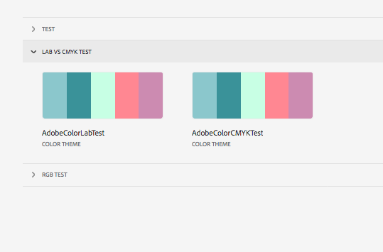

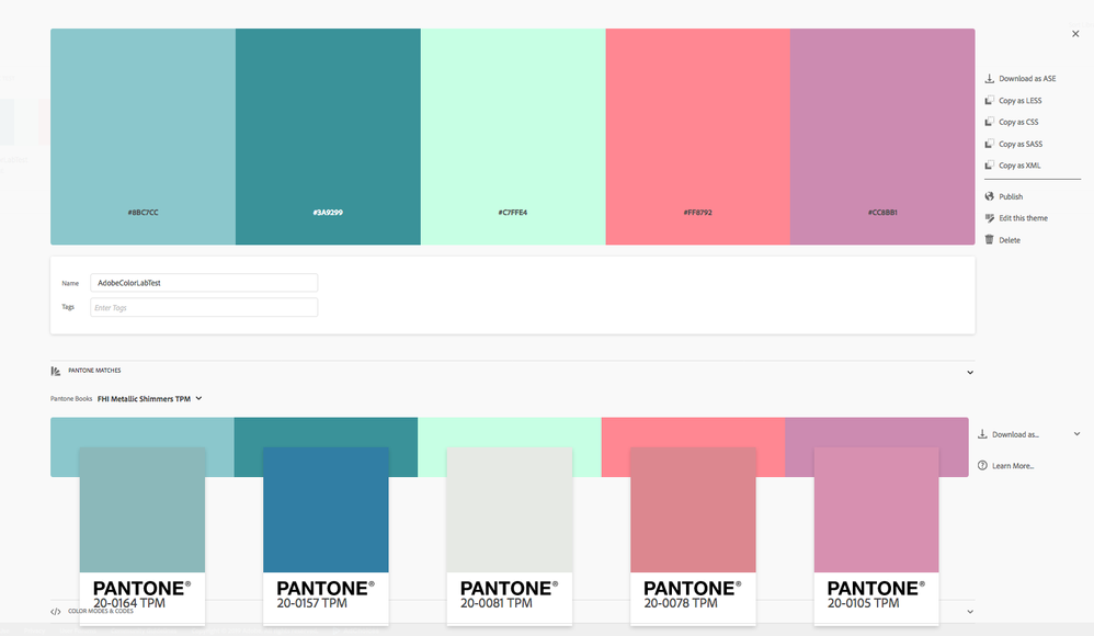

Community Beginner , Mar 09, 2020 Mar 09, 2020
Hi Rob,
Great, found it! Thank you. Yes, it wqas unclear this process had to be done on the website.
However, after now finding out what it's done it's probably better to still select colours manually.
As you can see from my screengrabs it shows the spot colours, BUT as per the other documentation you shared, it doesn't actually give you a solid spot colour when imported into Adobe software (ie InDesign) 😩

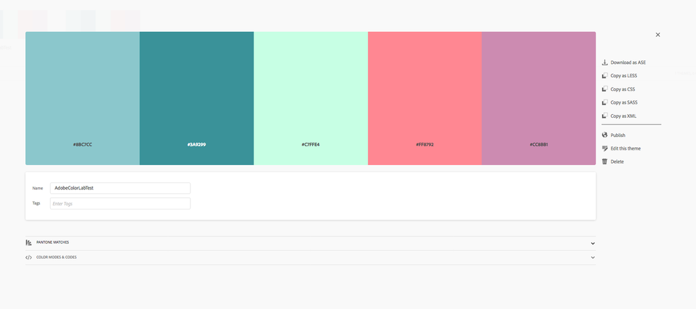

This is the article I found with the way to achieve what I'd like to do…
This is the section I am trying to follow…
This is a screen grab of my test document, the colours sampled from the image, and me not being able to find "Pantone Match" anywhere at all…
I believe there should be a simple way to create matched spot colours to the selected colour theme? It may be I only want one spot colour and it sounds so simple to be able to do it… if only the "Pantone Match" could be found .
Right, the .ase files are not saved as spot colors and the RGB definition is also a problem (Pantone Solid Spot colors are defined as Lab). The appearance of the web colors will change depending on your CC document’s assigned RGB profile—try assigning a wide gamut RGB space like ProPhoto vs. sRGB and you will see the problem.
The Adobe Color web app is great for finding color relationships, but the color management limitations of HTML mean you have to limit the Color Modes you save in to either Lab or sRGB (the web CMYK values are not reliable).
If you choose RGB as the Color Mode, your CC documents have to be assigned the sRGB profile in order to keep the color appearance
