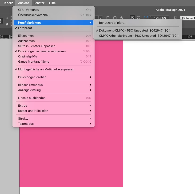

When I open InDesign, create a new document with these settings (sorry, in German),
create a reactangle in C = 0, M = 100, Y = 0, K = 0, this is what I see with “proof colors” turned off:

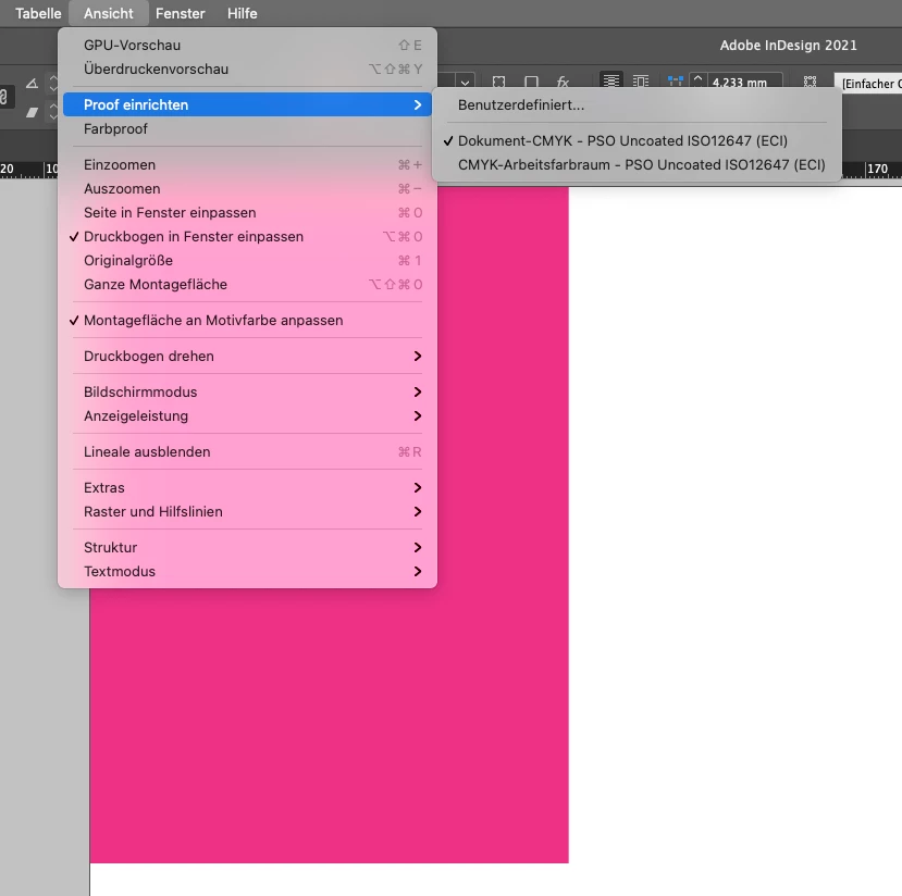

And this with “proof colors” turned on:

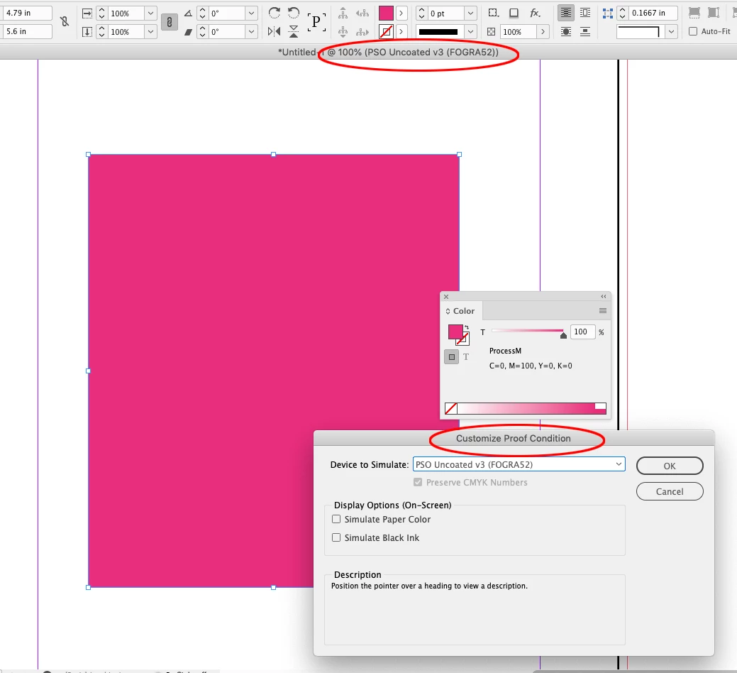

Yes, I’ve seen that happen and it seems like a bug. Try setting a Custom Proof Setup using your Document CMYK profile. I get this:

I've been trying to find out which CMYK standard InDesign is using as default.
The application uses the current Color Settings’ CMYK Working Space—there is no default.
When you create a new document, and the CMYK Policy is not set to Off, the Color Settings’ CMYK Working Space gets assigned to the document, and the assigned profile is used to color manage the CMYK preview (Edit>Assign profiles...). If there is no CMYK profile assignment the fallback is to the Color Settings’ CMYK Working space.
So here with Proof Colors turned off you can see the preview of document CMYK colors is dependent on the document’s profile assignment:
