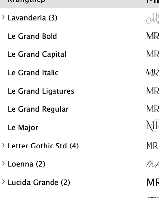

@MW Design  This thread is several years old, but I have a question that seems to line up with what you were talking about back in 2018 and wondered if perhaps you could help me. I am working on an indesign mail merge envelope document where the font has ligatures. I want the font to have the tracking set at 150, but when I set the tracking above 10, it automatically changes it to the normal characters instead of the ligatures. *Of note, I'm a relatively new designer and know little about the technical jargon, so pardon me if I miss something in my explanation.
When I design in illustrator, it'll keep the ligatures no matter how far it is tracked, but it won't let me do it in indesign. Now, I recognize that in the discussion being had here, it didn't make sense to keep the ligatures when the tracking got too big because then the spacing looks funny. The font I am using doeson't have that problem; it looks fine tracked out. Is there a way to override the indesign default to remove the ligatures so that I can keep them? The panel shown here from QXP (which I don't even know what that is) is what I need, but can't find anything in indesign that would allow you to change that even 3 years later from this thread.
Any help? I'll post a few pictures to show you what I'm trying to accomplish and the font. The font I am using is Le Grand Ligatures. It seems to be a separate font face than it's own Regular, Bold, etc. Help? Could it be a script?
My only other thought was would there be an option to set the tracking at 10 as it wants and then change the tracking in acrobat like a customizable preflight option? Any help would be much appreciated. I really don't want to do this manually.
-Rachel
