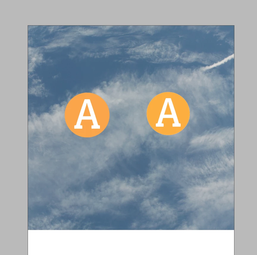

I know it happens to export PDFs with sometimes white lines that shouldn't be there, which when they are printed disappear (picture1).
But this is the first time that in addition, there are also some in the print (and not necessarily the same) (picture2).
It's been happening to me for 2 days now.

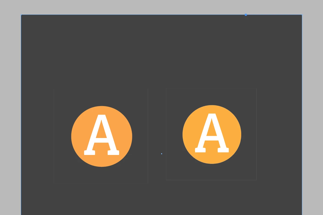

Here I have a placed Illustrator AI file on the left, and an exported PNG of the AI file on the right:
If I open the AI vector file in Illustrator, I can see there is a rectangle behind the yellow circle with a .1pt stroke.
InDesign doesn’t show the stroke because the background image is interfering. If I hide the image I can see the stroked rectangle in both the PNG and AI files when they are on a dark gray background:

If the lines are showing in a PDF/X-4 export, and in print output they are not stitching artifacts, which can occur when live transparency is flattened on export (PDF/X-1a). Looks like the placed logos are PDF or AI files? Without seeing the file and assets I would guess there is a hairline stroke somewhere in the logo file, or applied to the logo’s parent frame?
August 10, 2020
Thanks for your return.
In fact, it seems to be random. I tried to use many formats (EPS, AI, PNG...) of the same picture, whites lines were always there. I checked open it in AI : there png was indeed parasite by...sort of invisible cubes, which souldn't been there. Is that what you call "hairline stroke" ?
Then, I tried to import another PNG in ID, white lines there too. So I did same shapes but directly on my current working page, no importing anything. No longer white lines appeared.
That was the time when i thought i fixed the matter.
But when I opened another file, and copy paste the "good" shapes from when it worked, then again, white lines.
