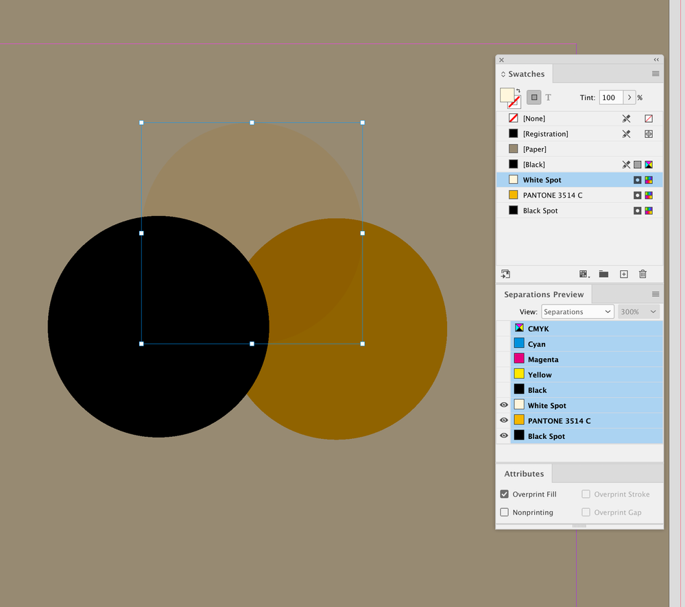

Hi @stefanofe , This has been a long running problem with InDesign (and Illustrator). There is no color management for Spot color overprints or tints in either application, so for Spot color output where the inks might be opaque, like screen printing, you have to ignore the Overprint Preview and check the separations in Separation Preview.
Here my [Paper] swatch is set to simulate cardboard, and with OP turned on my White Spot fill is displaying as transparent, as is PANTONE 3514, which is what would happen on an offset press where process as well as Pantone inks are transparent:
I have to check the Separation Preview for White Spot to confirm that with a separated output the fill is indeed overprinting
