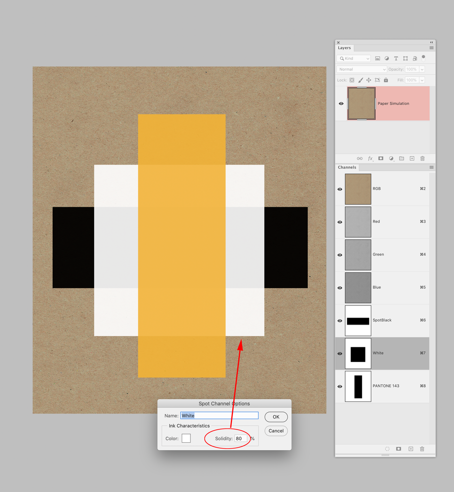

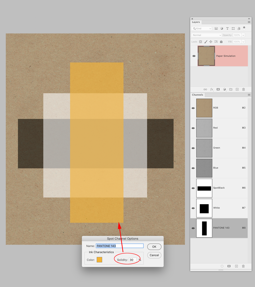

I’ve attached a sample .PSD with 3 spots
Here my Spot Channels are overprinting on a cardboard simulation with Solidity set to 30%:
I can increase the Solidity to 80%, but if you have any experience with offset printing this is not going to happen on press:
For a client view I can Merge Spot Channels, but I think this 80% Solidity view would be misleading:

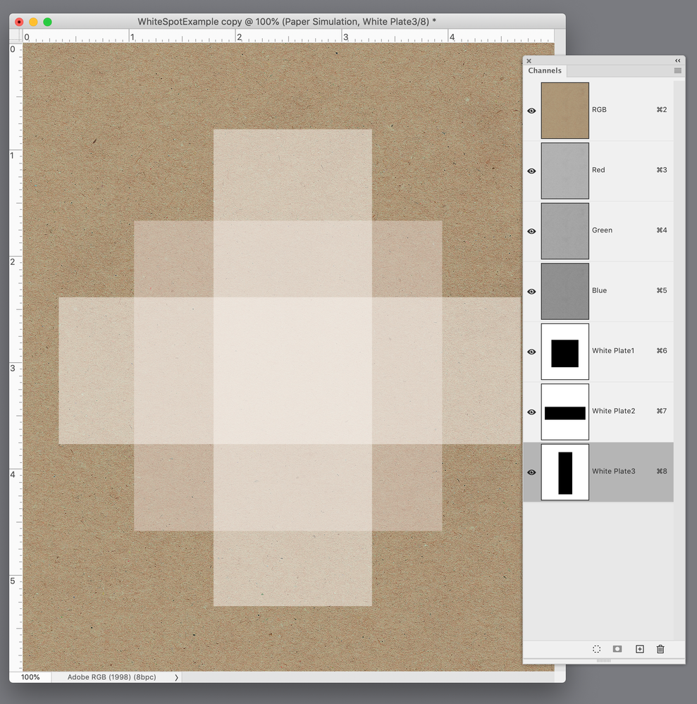

Hi @reproo2773183 , I do wish InDesign included something similar to Photoshop’s ink Solidity feature.
In Photoshop I can actually preview a hypothetical 3X hit of White ink on Kraft paper. While this does not provide the accuracy you might expect from color managed process inks where a press profile can be assigned to the process color, it’s certainly better than the InDesign options:
