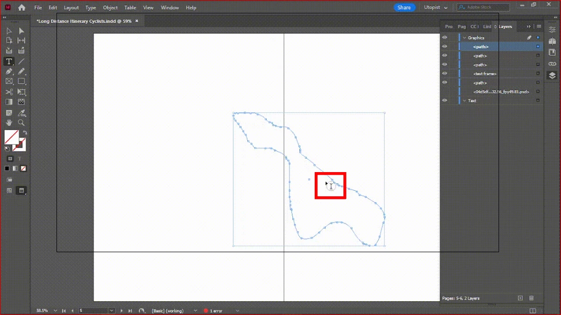

Why can't I fill the shape with text in InDesign?
  • December 1, 2022
  • 1131 views
I have hidden the image, this selection is on an image.
If I try on an other selection on an empty page, it works.

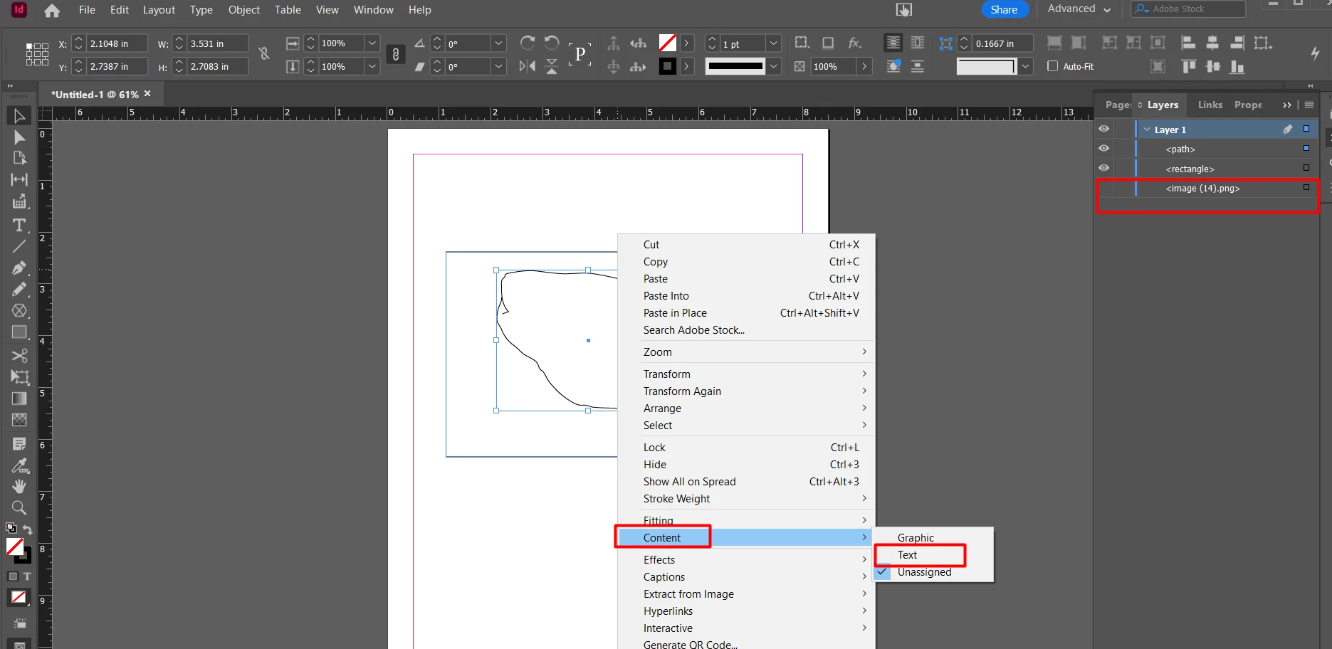

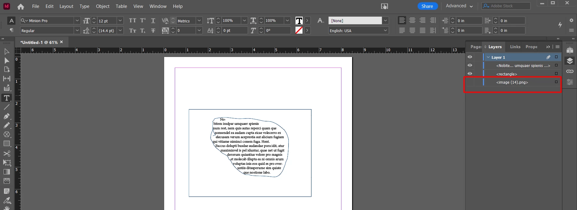

Thank you for reaching out and sharing the video. It looks like the shape you created needs to be converted to a text path.
Please see the attached image:-
To fill your shape with text, Right-Click on the shape and choose Content > Text. Please see the below image for reference.
Let us know if that helps.

At first I thought your path might not be closed. That is a common cause. But then, almost at the end of your video, you see that filling with text is possible --> the correct cursor appears:
December 2, 2022
No - you don't need a closed path to make a text frame 😛

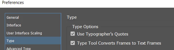

At a guess - the preference is not checked
As when they click into the shape - you don't even see the blinking cursor come up to show it's active.
So my theory is that it's not being converted to a text frame.

I didn't actually see an attempt to click into the path with the cursor in the circle. I did notice, however, that re-selecting the Type tool seemed to lose that cursor.
Wouldn't surprise me if there's som corruption in the file. Try an export to .idml.
Harshika Verma
Harshika VermaCommunity ManagerCorrect answer
December 1, 2022
Hi @Chris P. Bacon
