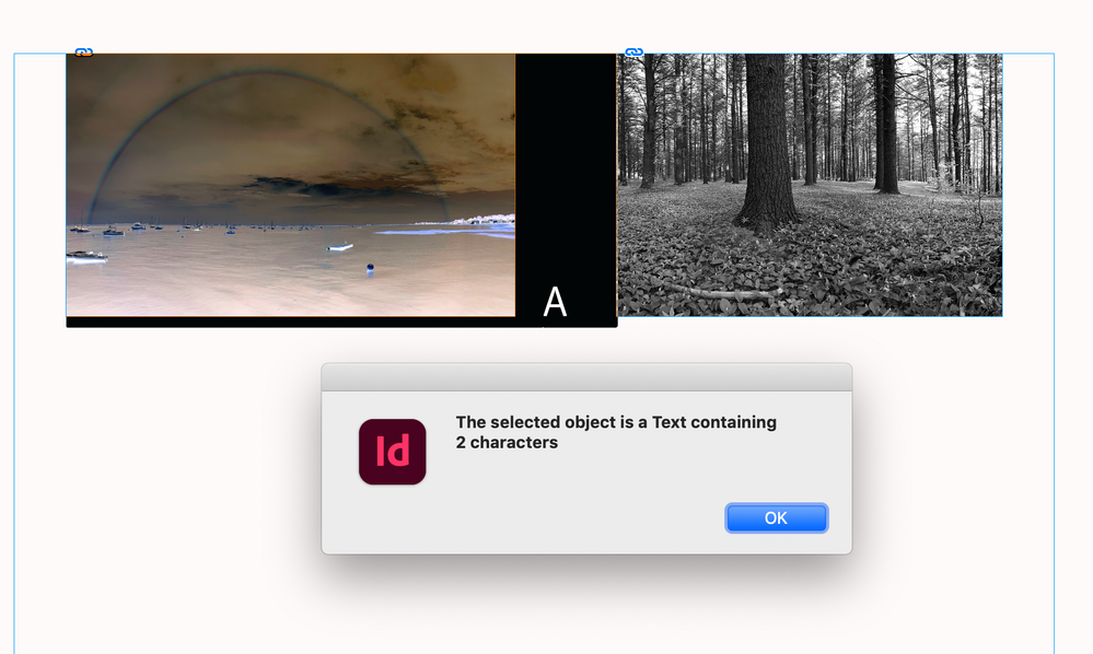

Hi @Jeff33740050deru , One thing to consider is an anchored image is treated as a text object, and text selections have to be contiguous.
I can see this with scripting if I get a selected object
var s = app.documents[0].selection[0];
alert("The selected object is a " + s.constructor.name + " containing " + s.characters.length + " characters")
Here’s a selected text frame with 2 anchored images—if I run the script it returns a count of 3 characters (not images):
If I select the first image and the character "A" I get this:
