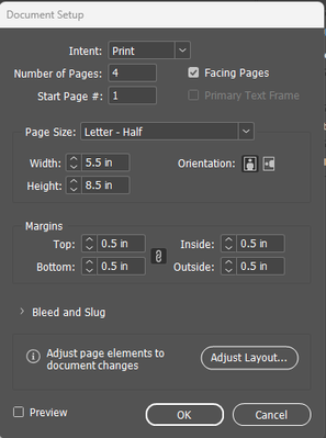

This document hasn't exhibited this behavior before. I created a "new" document by saving the original as something else, then deleting all the pages except the first. So nothing should have changed in the setup. Here's the setup panel.
 "Smart text reflow" is on, set to "End of story."

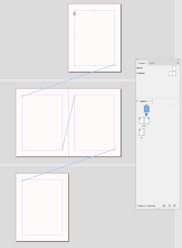

It looks like there were two page breaks at that point, which indicates two bugs (or two facets of one): With only one page break, there was no second page. With two, there were two pages added but in the wrong placement.
I deleted all page breaks and inserted one. It added one page (but only after I typed some jibberish characters), but added it on the right side... which is wrong.
Adding a second page break (and typing some characters) added a third page, again to the right of the first two and created a bogus three-page spread. And as an added bonus, content flow is broken between the second and third pages:

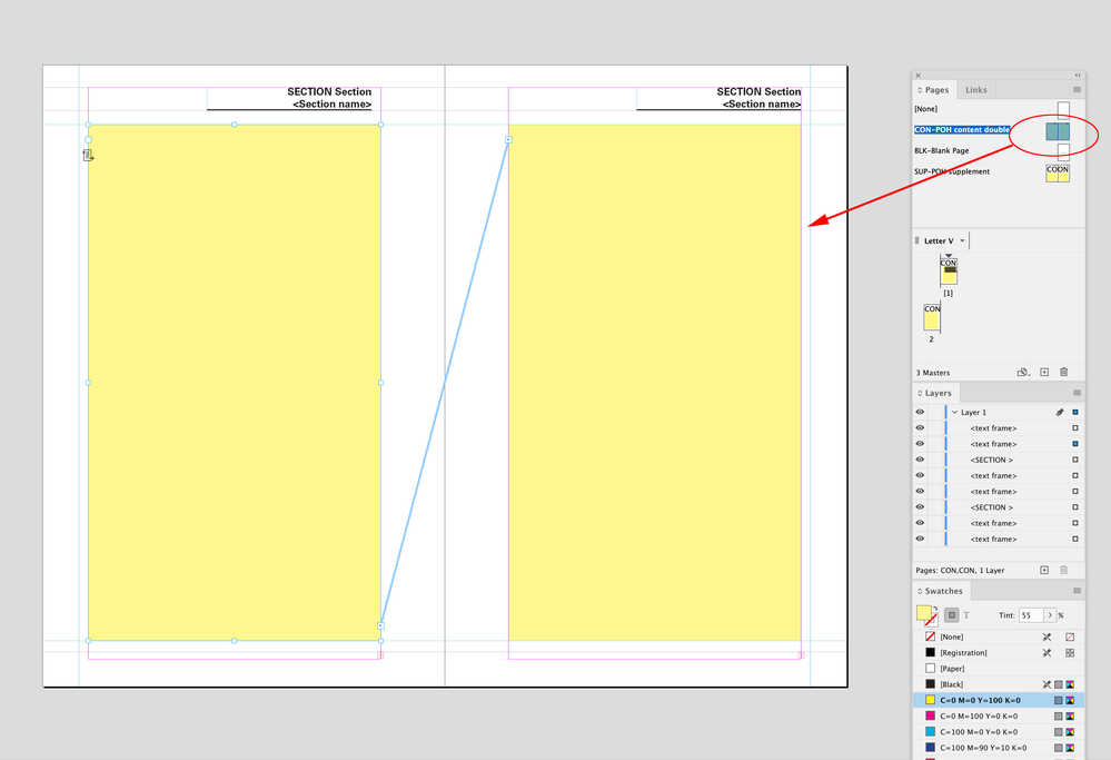

Also, a book with gatefold spreads would need to be setup with some 3 page or more spreads—that’s the reason for the option allowing some, but not all, spreads to shuffle:

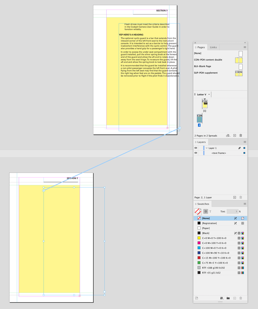

You’ve drawn a new text frame that is not associated with the Parent on the page—the Primary Frame is there, it just hasn’t been released and is under your frame containing the text.
Shift-Command-Click a Parent Page item to release it and convert it into a Page Item that is linked to its Parent. Or there is the Page Panel’s Override All Master Page Items, which will convert all the page’s Parent Page items:

Thanks, but no; I have not. I have never drawn a frame on a child page. All the frames were derived from the parent pages. Thus the bug report.
This is why I didn't bother stripping down and posting an example document: It merely exhibits the problem. I doubted (although didn't deny entirely) that it would reveal how it arrived at this state.
If I change the fill color of your Parent Pages’ Primary Text Frame I get this:
Your text is in a regular text frame—no association with a parent page. Not sure how you got that but there are ways it can happen—if I paste text with no frame selected, a new container text frame would be created to hold the text with no Parent Page association.
If I create 2 new pages at the end of your doc, select the Primary Text Frame, and paste your text I get this:
There are cases where Primary Text Frames are not automatically overridden—in those cases you have to Shift Command Click the Primary Frame in order to override it and add text.

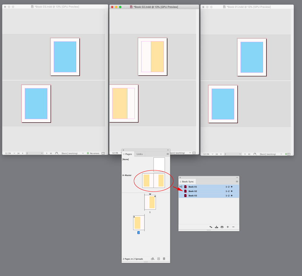

With a Book I can get it to happen if I check Parent Pages in the Book panel’s Synchronize Options, and then make a change to the Primary Frame of one of the document’s that is not the sync source document.
You might think about not checking Parent Pages in Sync Options, or only make a Parent page change to the Sync Source document
If you do include Parent Pages make sure you only make Parent Page edits to the sync master
