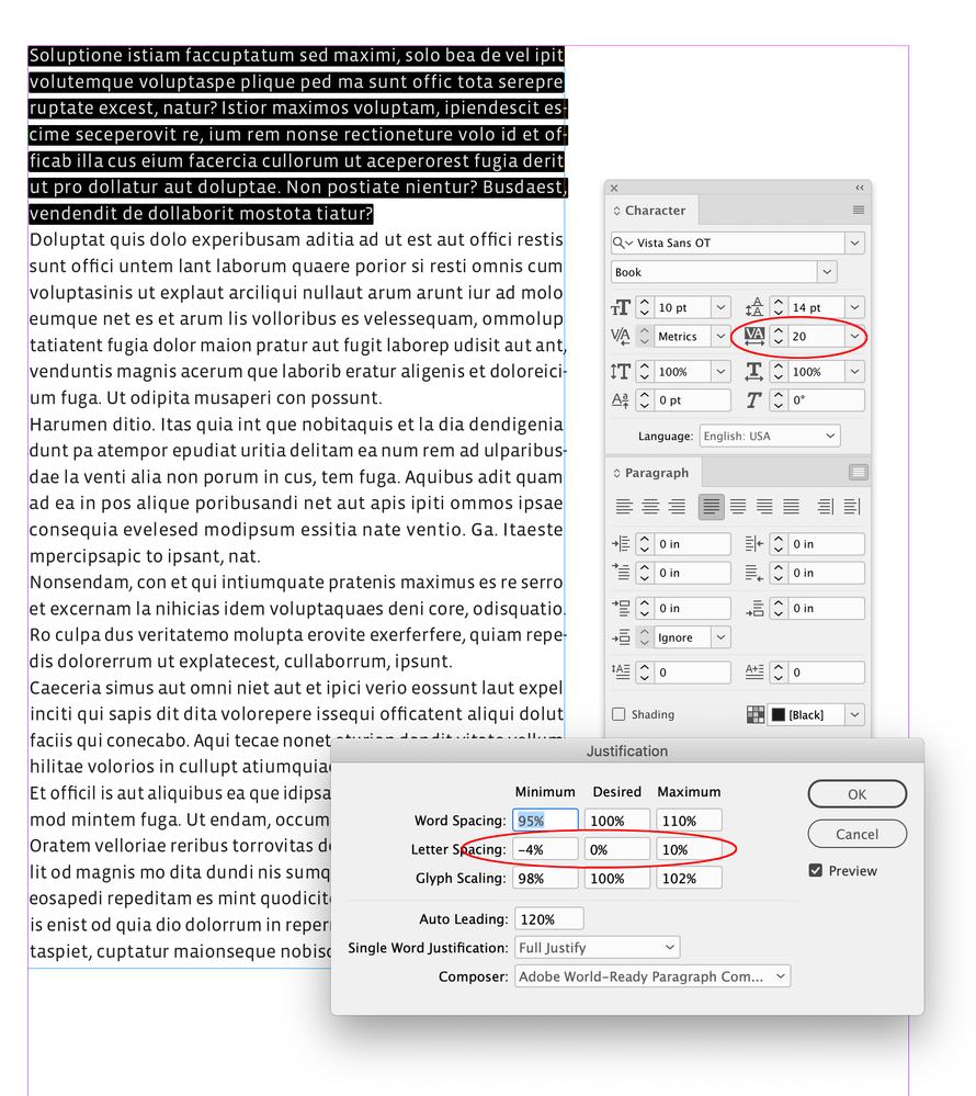

The justification and composer setting would also affect letter spacing:

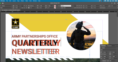

I attached some screenshots if you're interested. One is from Illustrator with the settings shown in the Paragraph box, and the other is from InDesign (the red text is the live text in InDesign with the same settings as Illustrator. The black text behind it has been outlined in Illustrator and pasted into InDesign for you to see the difference).

Also it looks like you might have custom Kerning set in Illustrator. Does it happen if you select all of the text and set the Kerning to Auto or Metrics, which is what you have in ID?
Community Beginner ,
Sep 12, 2021 Sep 12, 2021
Thanks rob, yes I noticed the kerning too. I tried it with the kerning adjusted, and it doesn't do it on my end. For now I will manually adjust the tracking down so that it matches the look from Illustrator, but I'd love to learn more if anyone comes up with anything.
