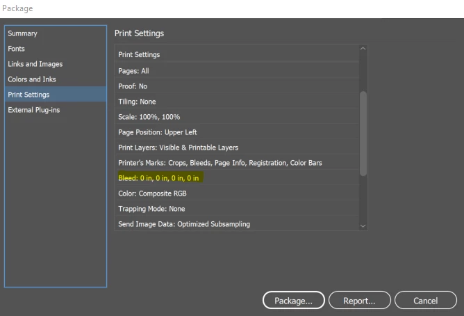

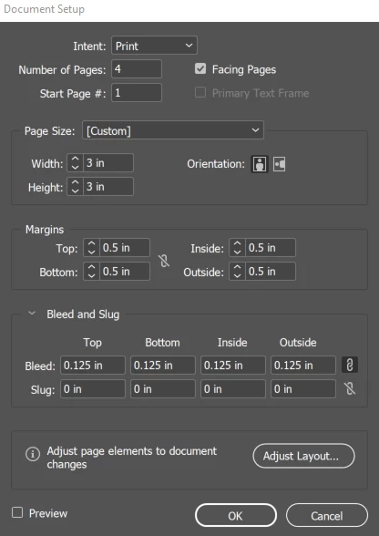

I'm trying to send out a pdf to the printer for a file created in InDeisgn. When I set up the document I create it with a 0.125in bleed, however once that project is converted into a pdf, the bleed (print settings) revert to 0in.
This seems to be a recent issue as this has only been the case for the past couple months. Before, everything worked just like it always has; I set up the document, the output is exactly how it was set up.

That's a print setting, not a PDF export setting. You're not printing to PDF are you?
Nani BearAuthor
June 7, 2022
Ultimately, yes. InDesign used to allow me to export to pdf with the document settings of 0.125" bleed showing in the exported pdf for my printer. Now, for some reason, the document settings are not carrying over to the export settings or the print settings like they used to and I can't seem to figure out how to fix it.
Nani BearAuthor
June 7, 2022
You are showing the Print dialog—save an Export preset with Use Doc Bleed Settings checked and Export the PDF
Thanks, and yes, I have that set up too. But alas, every time I print to pdf, export to pdf, or package (which includes a pdf) none of the settings are saved - by none, I mean in the document preset, print preset, or export settings. Anytime I try to get a pdf of my document, the bleed settings are not carried over to the pdf. I've tried so many different iterations of combinations of settings to get the bleed settings to transfer to the pdf.
