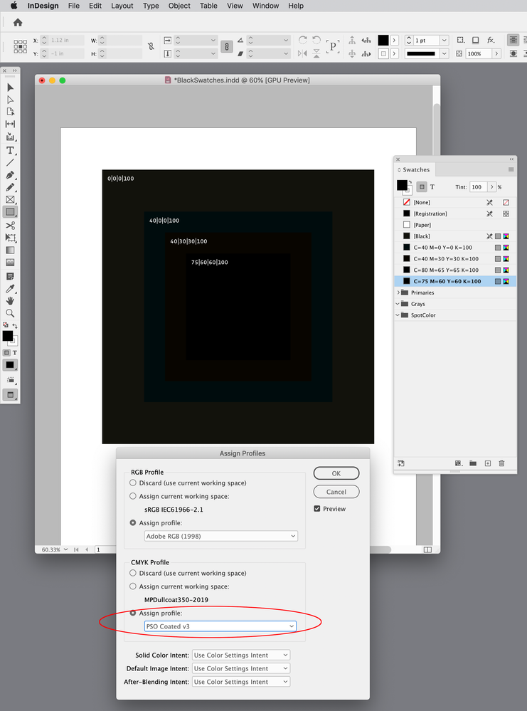

If you were not printing to an uncoated sheet you probably wouldn’t notice the 100% black problem. Here are scans of the same CMYK target printed on coated (left) vs. uncoated (right). The difference between black only and black + CMY is much more noticeable on the uncoated sheet:
You need to be working in CMYK in order for a CMYK profile to display the Black only vs. Black + CMY difference. Here are black comparisons in InDesign:

Do have decent communication with the printer? It shouldn’t be a problem to send a CMYK PDF with everything on the Black plate—you just would want to make sure the K values are output unchanged.
Moving grayscale to a CMYK black plate can be done with a Photoshop action. Here’s an example:
https://shared-assets.adobe.com/link/c683bd85-235f-425f-45e4-4e0846fca6d6
