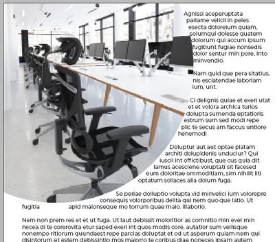

How do i increase the white space between my object and the text itself? as you can see from the image below the text is far to close to the object. I've tried to 'fake it' by adding a stroke to the circle object but it would seem the "Wrap around object shape" function ignores strokes...
Any help is appriciated!
