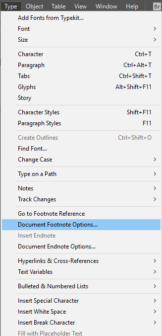

the raised position is not proof. If your import settings were to keep original formatting, InDesign could just get the appearance without any other options. But if you are sure they are references, you can set their formatting:
1. Type > Document Footnote Options
2. Set the Character style for references, including size, position etc. You can create the style in advance and choose it or use the New Character Style option and create the style instantly.

do they keep the Reference status or became to normal numbers? If first, you just have to change the footnotes settings (Type > Document Footnote Options) If last, you will need to create new footnotes with needed reference formatting and put the footnotes texts in the proper place.
