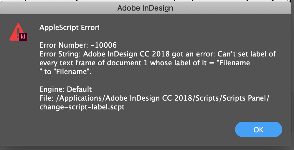

Hey, I'm trying to remove a hard return I have in some of my script labels on an InDesign document, but keep getting the error. Each page has multiple layers each with a text item that contains the label.
Here's the script:
tell application "Adobe InDesign CC 2018"
tell document 1
set label of (every text frame whose label is "Filename
") to "Filename"
end tell
end tell
Thanks!

I get the same error if there are no text frames in the document with the "Filename" & return label—it worked the first time, but not when I ran it again. I think you need to catch that error:
	tell document 1
		try
			set label of (every text frame whose label is "Filename" & return) to "Filename"
		end try
	end tell
end tell
	tell document 1
		try
		end try
	end tell
end tell

The script works with  either \r or & return, but only once—you need the try statement.
