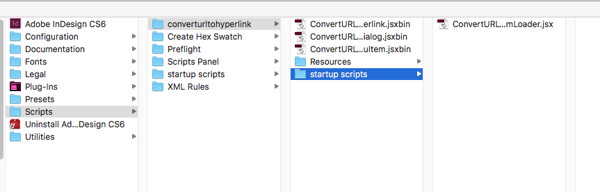

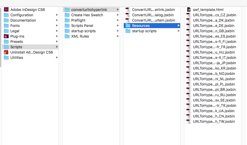

Uwe, is right, I misread the path in your error capture. The Scripts folder structure would look like this:

The install "Java for OS X 2015-001" refers to Java not Javascript, but it could be part of the problem. For CS6 to run on newer versions of  OSX you need to install the legacy version of Java. Here's the Apple download page for Java 6.
