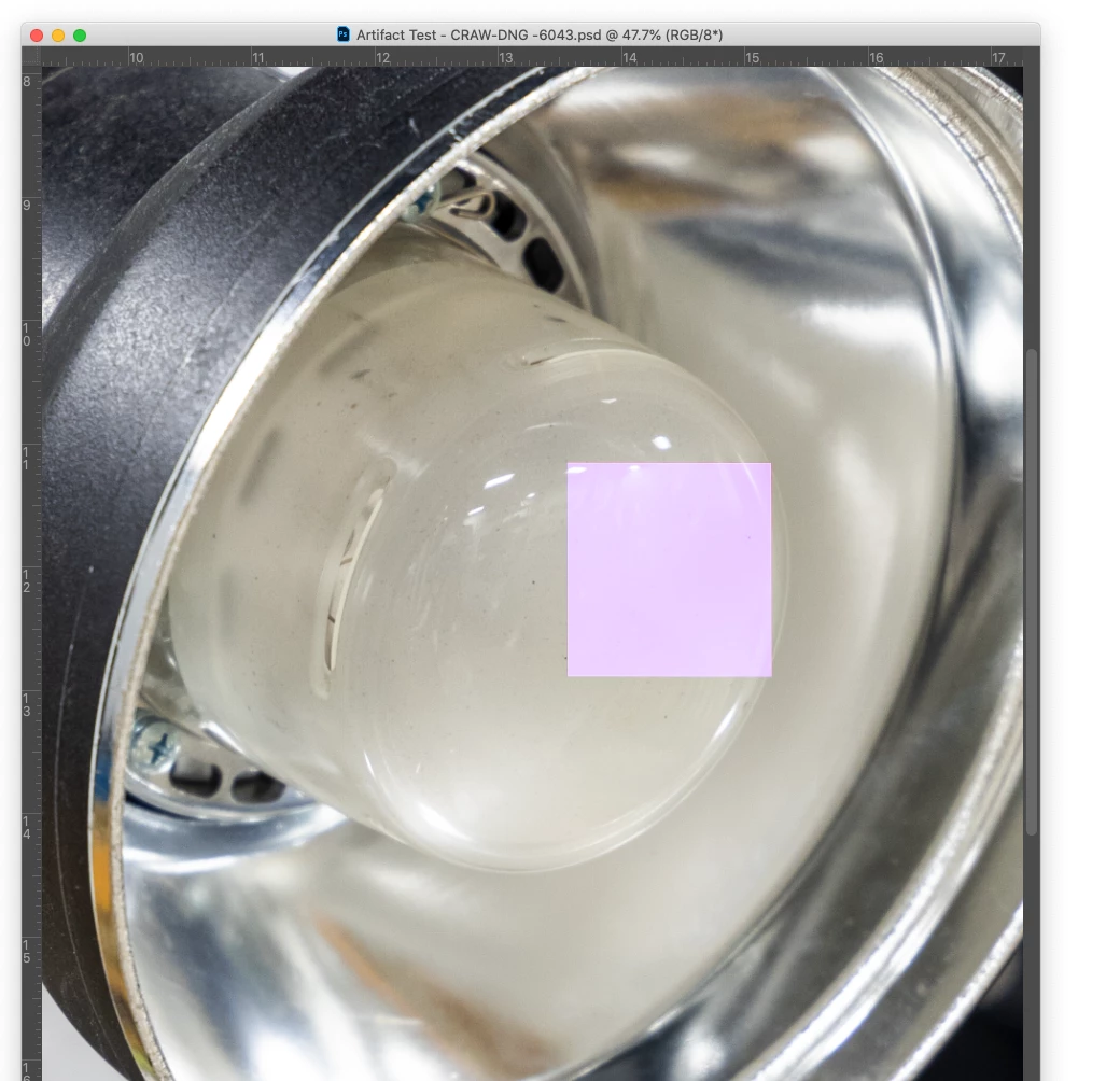

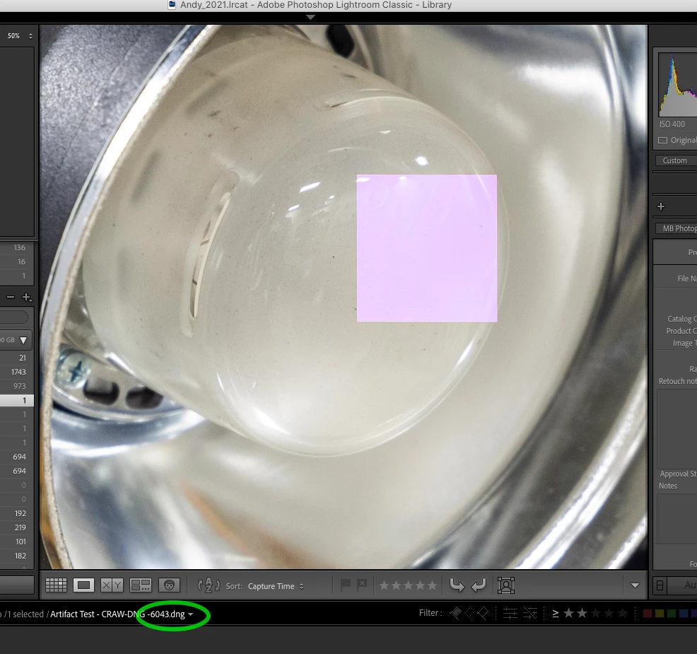

I am consistently finding all spot removal adjustments rendered as pink block artifacts after converting to compressed DNG. I am using LR Classic 10.1.1 on a 2017 15 inch MacBook Pro running macOS Catalina 10.15.7. I've seen the problem with a Canon R5 (raw and c-raw), Canon 5DmkIII, and Fuji X-T3 (RAF). The artifacts don't immediately appear - only when rendering 1:1 - so they are easy to overlook. I can remove the artifacts by modifying each spot removal adjustment in some way (often I'll just select an adjustment and nudge the feather slider up and down by one so the adjustment isn't affected). Also, there doesn't seem to be a problem when adding spot removal adjustments to images after they are converted to compressed DNG. Not sure how long this problem has been around - I've just discovered it when testing compressed DNG as a possible way to manage file sizes from the R5. Here are screenshots showing the original raw, compressed DNG, and exported PSD...

I just exported the file as a .jpg and now the pink blocks no longer appear in LR Library E or G mode
June 30, 2022
These strange pink pixel blocks (not sure what else to name them) appear on this image, only in Library mode. Switching to Develop mode, they disappear. I figured out what the issue is, but not why: the blocks are in exactly the same positions that I used the Spot Removal tool. So Library mode displays Spot Removal from Develop mode as pink blocks. It should also be noted that I converted the RAW .NEF files to .DNG.
This is definitely something buggy that I have not seen before. The screenshots are attached. Thanks

Re-exporting the affected lossy DNG files as shown below with Embed Fast Load Data unchecked appears to fix the issue without touching the image data. You can do this as a batch export to a subfolder, then delete the original lossy DNG files and move the new files to the original folder.
