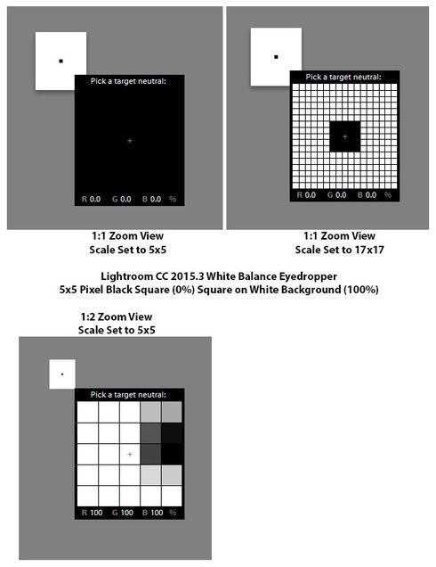

The capability to use larger sample sizes with the White Balance Eyedropper tool was implemented in LR4:
http://feedback.photoshop.com/photosh...
This capability is no longer working properly in LR 5, 6, or CC 2015 and uses a fixed 5x5 pixel sample area regardless of 'Scale' or Zoom View settings. Please see the following test images for clarification. Tested with Windows 7 SP1.

UPDATE: It appears only the RGB values displayed in the eyedropper tool are incorrect. The applied WB correction uses the actual Scale setting sample area. See this post: https://forums.adobe.com/message/8929708#8929708
It still can cause confusion and should be corrected to show averaged RGB values for the actual Scale setting sample area.

Continuing our discussion from the above forum link, Steve indicated that the white balance tool only displays the value for ONE pixel where the eyedropper is at.  I created a photoshop white square with a single black pixel to test.  The wb tool displays the values for a 5X5 sample and not just a single pixel.  Unfortunately it also displays the 5X5 sample if the tool is set for 17x17.  At least is uses the 17x17 sample for setting the WB when it is clicked.  This should be considered a bug or at least a bad design.
LEGEND ,
Aug 09, 2016 Aug 09, 2016
That is what I'm seeing as well. The eyedropper tool RGB display values are calculated using a central fixed 5x5 pixel area regardless of the Scale setting, which extends to 17x17 pixels.
Here's another example that better illustrates the issue, with the WB eyedropper is set to maximum (17x17 pixels). The central cross-hair is placed on the corner of a 5x5 pixel black square (0, 0, 0 RGB) with a white background (100,100,100).
If the display reads only a single pixel then it should display 0,0,0.
If it is averaging over a 17x17 area then it should display (17x17) - (5x5) / (17x17) = 91.4, 91.4, 91.4.
LEGEND ,
Ok, you're right, the calculations from the above illustration would be:
So the result is a 5x5 average for the % both under the WB dropper area and under the histogram.
But the WB is still dependent on the full area, right?
And in the lower drawing in the first message, where it appears to be the central pixel is the value of the percentages, it is really that the zoom level of 1:2 is complicating things although it's unclear whether the zooming out is causing the eyedropper do use the non-zoomed pixels a couple out from the black so is in an all white 5x5 area at the original 1:1 zoom or something else, like using the central pixel is happening.

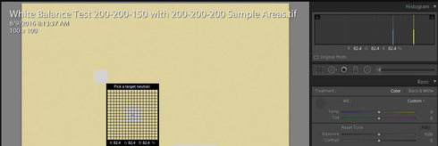

Jeffrey, nothing seems to have changed in LR CC 2015.7. The WB Eyedropper tool's display and the Histogram RGB readings still show a fixed 5x5 sample area, but when the Eyedropper is actually clicked it applies the WB using the selected Scale sample area (5x5 up to 17x17). This behavior is identical to LR CC 2015.6.1.
LR CC 2015.7
5x5 82.4, 82.4, 82.4 square on 82.4, 82.4, 65.4 background with a 17x17 Scale WB Eydropper centered on 5x5 square. Note the readings are 82.4, 82.4, 82.4 and not the "average" of the 17x17 mixed sample area.

Sorry for the delay–I've been on vacation with no access to a LR desktop. On my Windows 7 system the LR 6.12 Prerelease Update "fixes" the WB Eye dropper sample readings as follows:
1) The Eyedropper tool's RGB values  correctly show the "average value" for the selected sample size (5x5 through 17x17 Sample area) and NOT a fixed 5x5 sample reading. Good!
2) The Histogram RGB readings display the "average value" for a fixed 5x5 sample area. This is the same behavior as in LR 6.10. The Histogram's RGB values may differ from the Eyedropper tool's RGB readings .To avoid confusion it would be better if the Histogram displayed the same RGB readings as the WB Eyedropper.
3) The actual applied WB settings are correctly calculated using the Eyedropper Tool's sample area as selected in the Scale slider (5x5 through 17x17 selection). Good!
