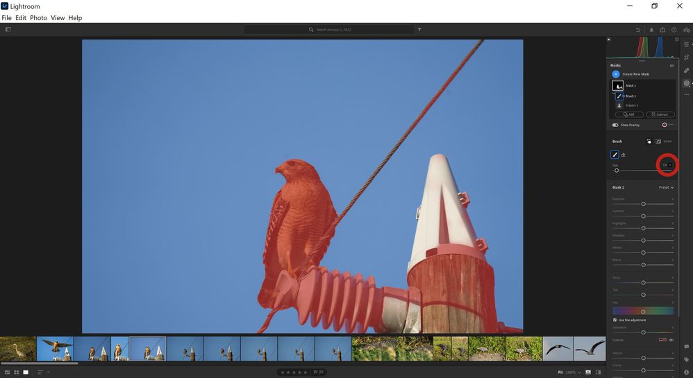

I am using the cloud version of Lightroom. Not Lightroom Classic. I can not find an option for adjusting flow and density of a brush. I can use raidial subtract but brush does nothing. It sounds like the same problem. Can anyone please help. Screen shot below. Thank you so much. Have been trying to figure out what i am doing wrong for weeks.
Sorry, I missed this message. So in case you still have this problem, and for others who may have the same problem: Click on the triangle in the red circle. That will reveal more brush settings.
