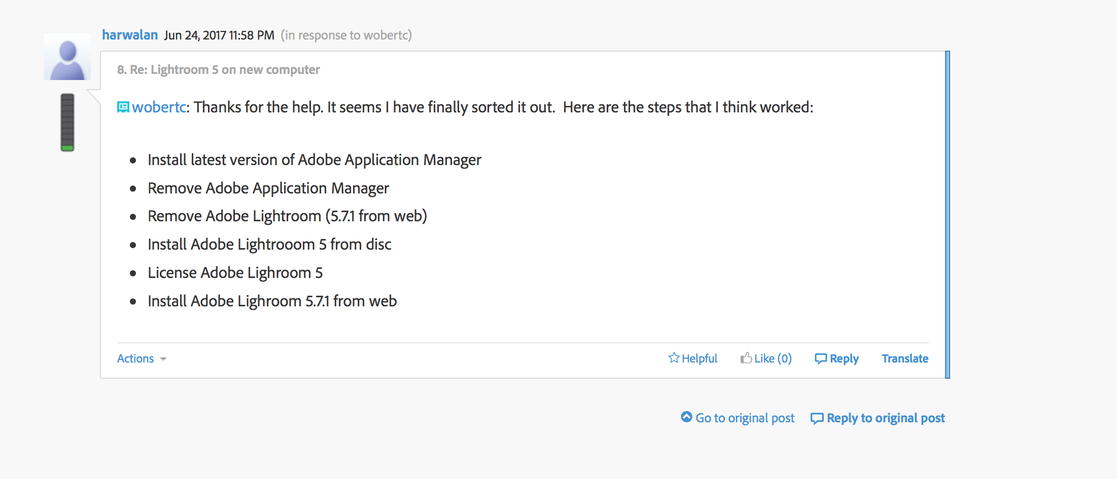

    In an other forum entry following the steps as described here helped (that user was also using 5.7): How to convert a Lightroom CC trial to Lightroom 6
    Here is the link to the forum entry: Lightroom 5 on new computer
    You may also follow this trail: Use the Creative Cloud Cleaner Tool to solve installation problems .
