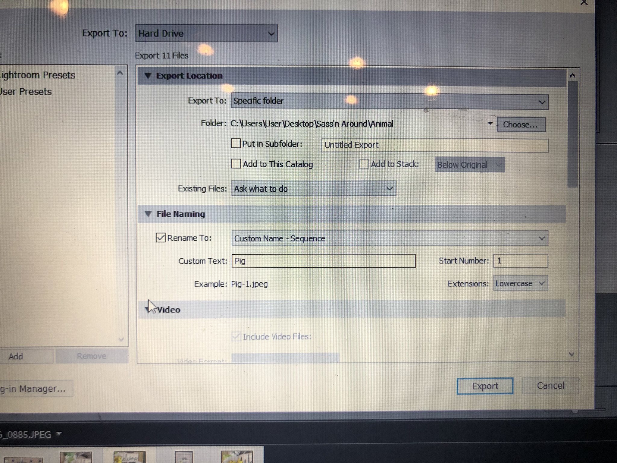

New Here ,
Apr 26, 2019 Apr 26, 2019
Hi Tony, here is a screen shot.  Does this help?

Then you are most likely exporting to DNG.  Please answer davidg36166309​ question in post 1.
Sorry, I see you already answered.  Can you confirm that it is JPEG?  It doesn't show in your screen shot.

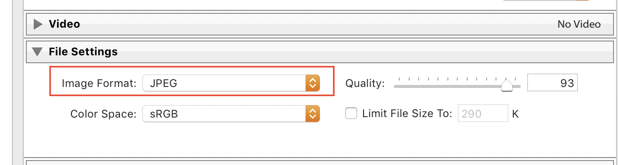

Still doesn't show Image Format.
We need this:
I don't work with an iPhone so I can't say if that might be the problem, but yes, you should be able to watermark a JPEG.
OK, the example filename in your screenshot says Pig-1.jpeg, so it looks like that is not the issue here.
