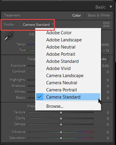

As I suggested in my reply please try selecting the 'Camera Standard' profile as shown below. The 'Camera' named profiles emulate the in-camera picture style setting and should provide a close match to what you are seeing when you selected 'Embedded Preview' for Import preview building. If Camera Standard doesn't match try Camera Landscape.

You have the Import module Build Previews set to use the Embedded Preview. This is the in-camera rendering, which can contain numerous styles and other settings that will look quite different than the selected camera profile in LrC. Try changing it to build Standard Previews and set the Develop module's Basic panel Profile  selector to Camera Standard.
