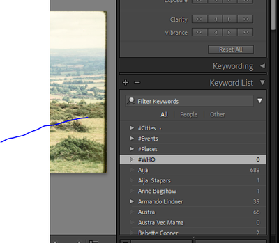

I am trying to learn about keywording. I have lists of keywords for people and also for other objects.
I realise that it is much easier to create groupings of keywords for  people or thing that commonly go together as this facilitates loading it into the metadata.
As I would am preparing to create a number of these groupings, it would be easier if they were all together in some place where I can select them..So far I have not found such a solution It seems that with people grouping they are placed in the same list as the individual identifiers..  I have therefore been exploring using names like the beginnin of the telephone directory such as aaamyfirs group. This seems very clumsy and I would like advice on how to solve this problem.
Thanks
Terence

You can have keywords inside keywords, thus effectively acting like folders and subfolders, and for each keyword the possibility to uncheck the "include on export" option.
Personally, I have ~what, ~when, ~where, ~who, etc... as main categories (I always use ~ in front of keywords/folders that are just for organizing and will not be exported).
~what is further subdivided into ~objects, ~animals, ~vegetation, and so on... Within animals I have among others birds (it is exported, so no ~) and within it pigeon, hawk, sparrow,...
Now, for assigning groups of keywords at once (or quickly), there are a few options. You can create keywords sets (in the Library's keywording panel) containing up to 9 keywords each. Just open one of those and you'll have butttons for the corresponding 9 keywords. Quite useful, as is also the "Painter" option in the toolbar (type one or more keywords and then "spray paint" them on the pictures). And of course, you can also create metadata presets that contain keyword sets for specific topics.
Hope that helps,
Michael

Rob_Cullen
May 7, 2021
I use the Groups like  Who, What, Where, etc-  (I slip up occasionally with an extra one in the 'parent' list!
I have one 'Parent' group dedicated to any new KW that does not match an existing KW- It will automatically be added to this Group-
("#NEW KEYWORDS"  appears at the top of the list because @#$% characters sort before ABCD characters.)
And I have nominated the "WHO#" group to be for all keywords marked as 'Person' KWs.
Regards. My System: Windows-11, Lightroom-Classic 15.1.1, Photoshop 27.3.1, ACR 18.1.1, Lightroom 9.0, Lr-iOS 10.4.0, Bridge 16.0.2 .
sockitAuthor
May 7, 2021
Hi Wobert.  Thanks that is clearly the key to the problem  I really appreciate your help.  I have made the Whats and Wheres  classify not as persons but as Others. However there is not much written about that group. I cannot find a separated display for that grouping so they are out there somewhere and I have not yet figured out how to deal with them. You seem to treat them as persons in that list is that correct?  What is the point of the "Others"?
Thanks
Terence
