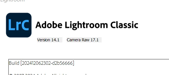

  • Lightroom Classic Version: 14.1 (with Camera Raw 17.1)

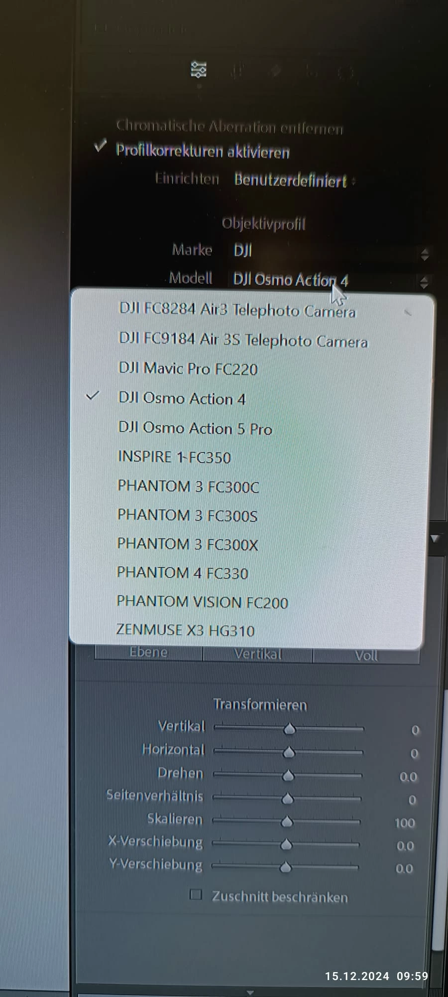

    • I can see the profile file named DJI FC9113 Adobe Standard.dcp in the folder, but it does not appear in the lens profile list in Lightroom Classic.
  2. Other Observations:
    • The DJI Air 3S Telephoto Camera profile (FC9184) shows up correctly.

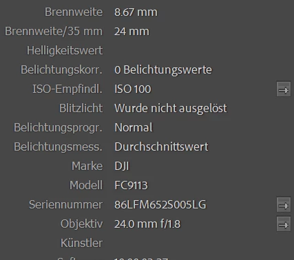

    • The files are DNG format, and I have verified the metadata (Lens and Model are recognized as FC9113).

  • Confirmed both are up-to-date (LrC 14.1 / ACR 17.1).

  • Lightroom Classic Version Confirmation
  • Lens Profile List (missing FC9113)

  • Metadata of the DNG file showing Model: FC9113

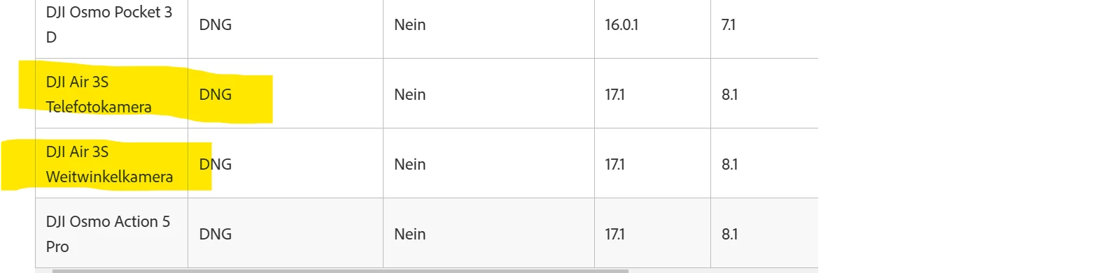

Note that camera raw profiles and lens profiles are different beasts. Camera raw profiles allow LR / CR to render the raw sensor data, whereas lens profiles provide corrections to lens distortions.  LR / CR provide camera raw profiles for both the Air 3S Telephoto camera and the Air 3S Wide camera:
https://helpx.adobe.com/camera-raw/kb/camera-raw-plug-supported-cameras.html

I don't know if this matters but I just re-installed lightroom classic and I see Air 3S (I want to know where the Mavic 3 Pro is???)
But I see the DJI FC8284 Air 3 telephoto loaded as a profile...  I found it under the Len Corrections if that is of any benefit...
