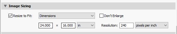

" It is cropping the photo to where heads are cut off." When do you see the heads cut-off? In Smugmug processing or from LrC? If LrC do you 'Don't Enlarge' enabled? I tried it both ways and noted a difference is image sizes with the following settings. Note that if you specify "inches" then DPI is also used.

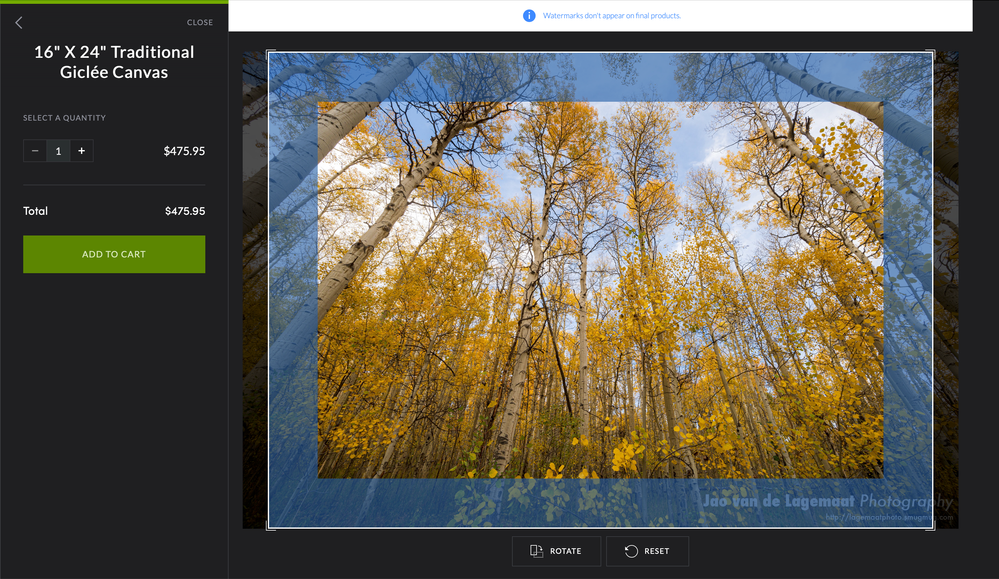

@DS256 is correct. If you use the wrap-around canvas in smugmug (or any print service), it uses very large borders for the wraps. You need to take this into account and it shows it in the preview when you try to order.
Alternatively use the stretched canvas option which does not wrap around the image at all or use the thinwrap canvas which has less of an border:
