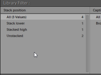

Assuming you leave the masters and VCs stacked, see this plugin https://www.photographers-toolbox.com/products/jbeardsworth/findreplace/index.php  You don't have to buy to use this Refresh Workflow Filters command. In this case, "Stacked high" would identify the top of the stack.
