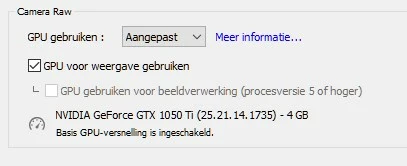

Mine is greyed too

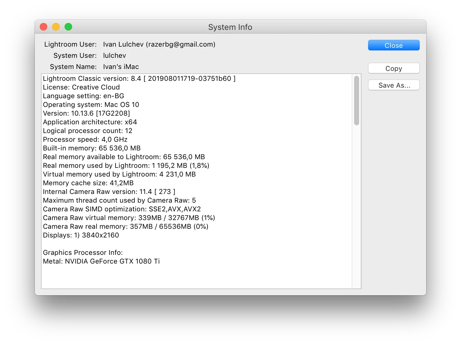

    After you get that GPU drive updates, see if it works, report back yes or no, and if no, include your system information (from LR, at least first line down to just before plugin info)

    I have the same problem for Windows 10.

    As of about 3 hours ago, officially a known issue. See comment by simonsaith, currently at the end of:
    No Graphics Acceleration v8.4
    simonsaith  wrote
    Thanks all for help troubleshooting and providing the log files to us. At this point, we can confirm that if your OS, GPU card and driver version does not support the DirectX 12/Metal, then the OpenGL based GPU acceleration fallback is no longer available in the latest LrClassic 8.4 release (also applies to ACR 11.4, LrCC 2.4). Although this is recognized as a bug, but the team has planned to drop OpenGL support in the next release. The reason is that some OS vendors have make it public that they will deprecate the OpenGL API soon.
    Practically, this typically means the bug will show up if you have a Windows 7 OS and/or older version of GPU card or driver. There is currently no known workaround for the bug. The team is investigating possible temporary relief. For the long term, customers are strongly recommended to consider updating your machine to the latest Windows and macOS and GPU drivers to take advantage of the possible GPU performance gain.

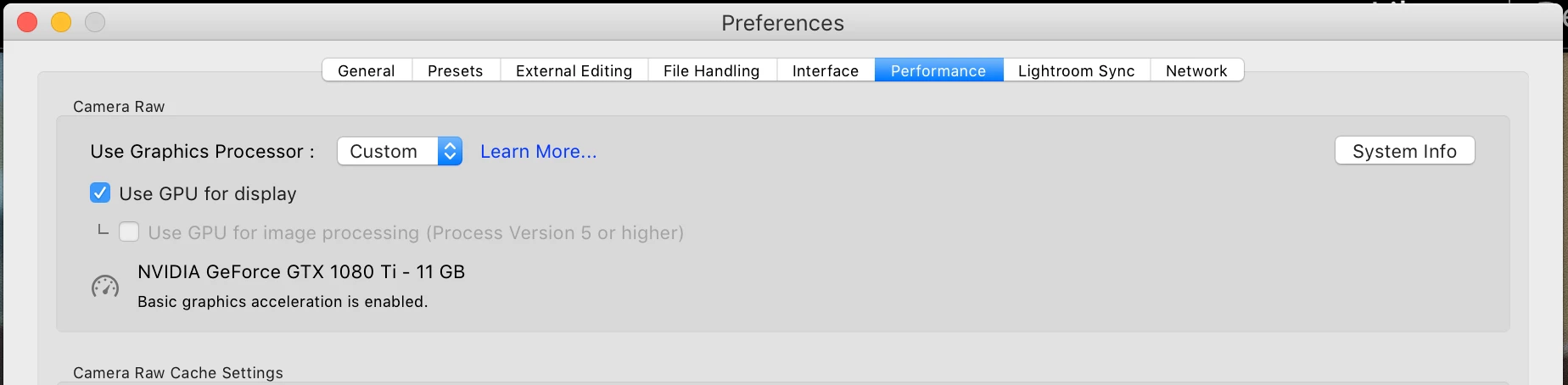

    You need MacOS 10.14 or later for the "Use GPU for image processing" check box to be enabled, and 10.14.5 or later is recommended.
    I don't think the GPU FAQ document for Lightroom Classic 8.4 makes this information very clear, and I'm working with the documentation team to improve that page.
    In the meantime please refer to the "Considerations for Graphics Processor (GPU)-accelerated features | Camera Ra1 11.4" system requirements at this link:
    Camera Raw system requirements
    With respect to these two checkboxes, Camera Raw 11.4 and Lightroom 8.4 have the same requirements.
    In addition to that, I do not know if on macOS the Nvidia GTX 1080 Ti will support Metal. I have not been able to test this configuration. This page from Apple documents Mac that support Metal: Mac computers that support Metal - Apple Support
    For folks running Windows, note that Windows 10 is a requirement for the 2nd check box "Use GPU for image processing." We have seen reports that some folks still using Windows 7 are not able to use the first check box "Use GPU for display," and that matter is under investigation.

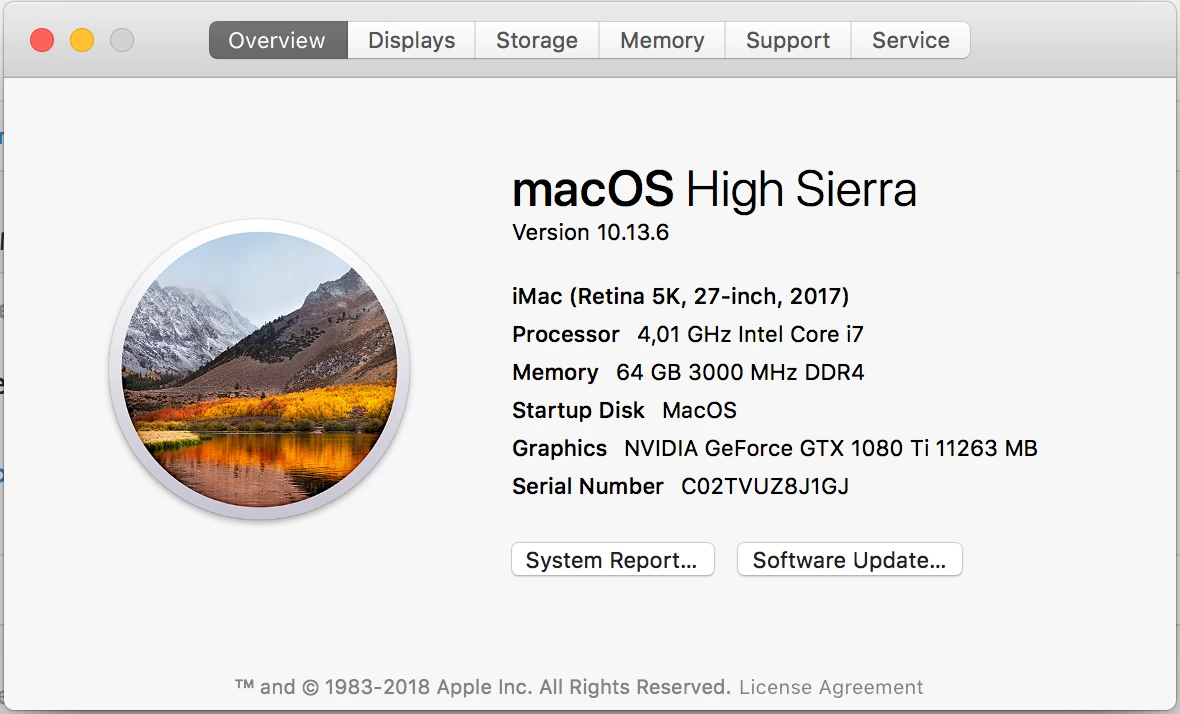

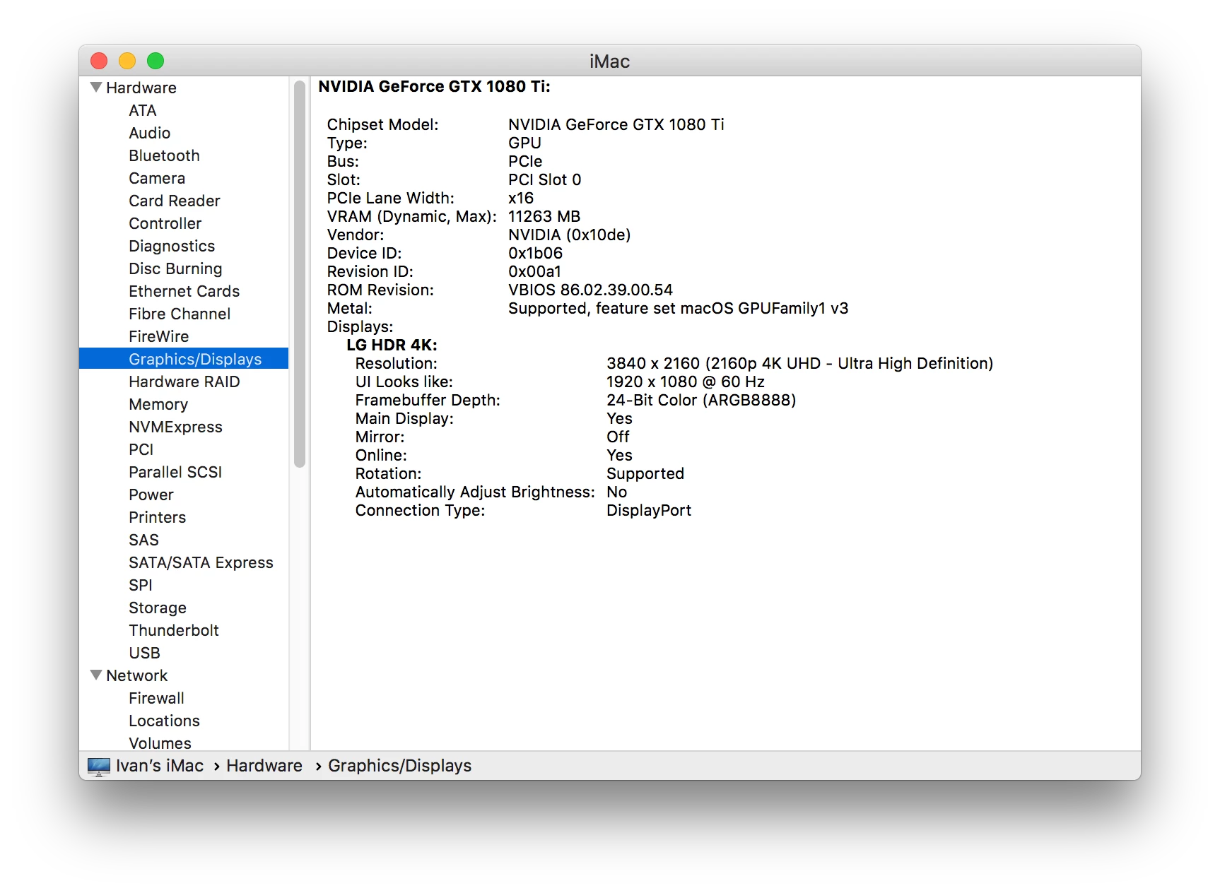

    LulchevAuthor
    August 14, 2019

    They want that: "Creative Cloud 2019 apps require macOS Sierra (10.12) or later" I have 10.13.3...
