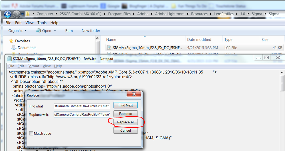

I had it installed and could no longer download lens profiles. The Lens Profile Downloader is no longer supported by Adobe.  It is also no longer included in the Lens Profile Creator. The easiest solution is to modify the available raw file lens profile for JPEGs. Here's a procedure I created.
Raw Lens Profile Modification for use with JPEG Camera Files
The Adobe installed lens profiles can be found here:
Mac: Applications/Adobe Lightroom Classic/Contents/Resources/Lens Profiles
Windows: C:\Program Files\Adobe\Adobe Lightroom Classic\Resources\LensProfiles\1.0
Open the RAW lens profile you want to edit (PROFILE_NAME - RAW.lcp) in a text editor such as Windows Notepad or Mac TextEdit (change Format> Make plain text). Find and Replace All instances (about 20) of:
stCamera:CameraRawProfile="True"
and change to
stCamera:CameraRawProfile="False"
Do NOT Save the modified file to the same location. Rename the file by changing - RAW to - JPEG and save the file to the below "user" folder location. The text editor may try to add a .txt extension to the file name. Retain the original file extension .lcp.
Mac: Macintosh HD / Users / [your username] / Library / Application Support / Adobe / CameraRaw / LensProfiles /
Windows: C: \ Users \ [your username] \ AppData \ Roaming \ Adobe \ CameraRaw \ LensProfiles \
Close and reopen LR to load the new lens profile.
