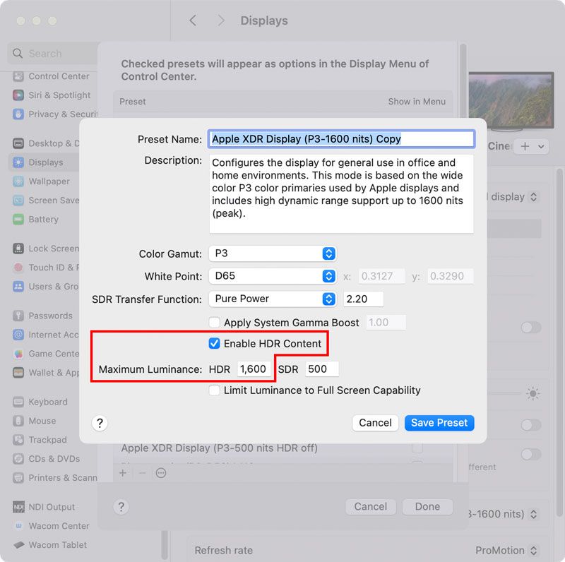

Make sure that you have enabled HDR mode in Displays section of macOS System Settings

In the screen shot, Built-in Display is selected, so the Reference Mode preset applies to the Built-in Display, not to any external displays such as the external OLED being asked about.
In fact — and I need someone to correct me if I’m wrong about this — I believe the Reference Mode presets apply only to Apple displays that support them (so, not even all Apple displays), and never apply to any non-Apple displays.
Finally, just for completeness, what enables HDR on an Apple display that supports it (such as the XDR display in the 14"/16" MacBook Pro) is not the Reference Mode preset exactly, but more specifically, if that preset has HDR enabled in it. So, HDR on an Apple XDR display can also be enabled by your own custom Reference Mode preset if you created it with HDR enabled. But again…I do not think this info is relevant when discussing any non-Apple display.
By @Conrad_C
I am pretty sure that you are correct.

YES!  This completely threw me... I've just spent an hour over at ArtIsRight's YouTube Channel, educating myself on these new Reference Presets.  I was tearing my hair out, looking for the "Enable HDR" option on the MBP's built-in display, only to find it six levels deep in the "Preset" fine-tuning options.
Interesting that the upper limit for HDR if you're starting from the Photography (P3-D65) preset is 500 nits.  You can't force it to 1600 even if you wanted to.
I gather this means the Apple XDR Display (P3-1600 nits) preset, which is enabled out of the box, is meant to put full control of the display brightness in the user's hands with the F1 & F2 Keys, as well as the slider in Control Panel. Any other configuration where you set SDR and HDR upper limits is meant to lock out accidental changes or prevent adaptive nonsense like ambient compensation and "True Tone" from screwing with your color grading session.  All very smart and welcome features, now that I know where Apple is hiding them all.
