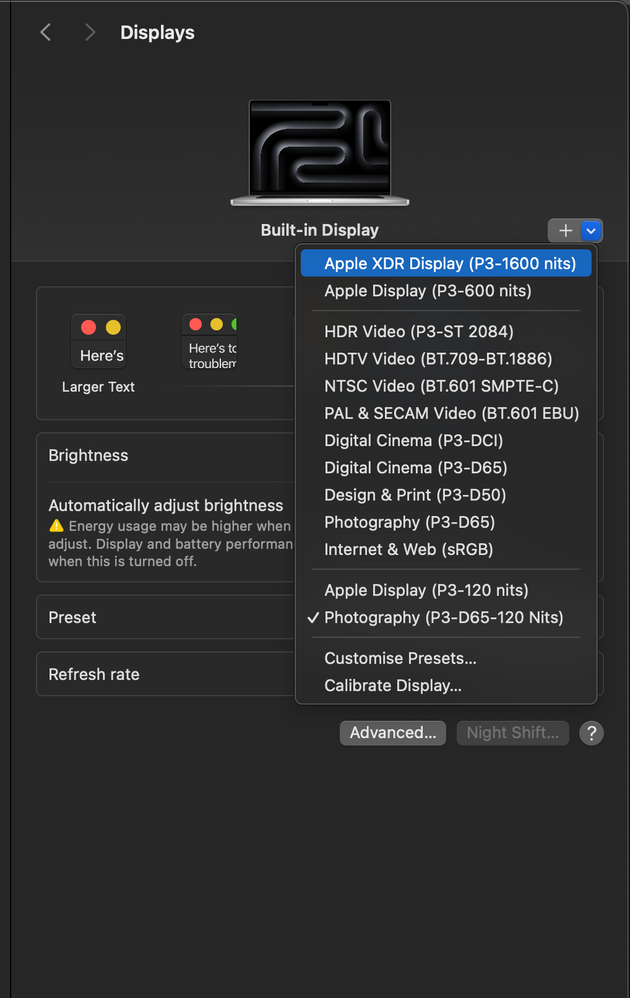

Make sure that you have enabled HDR mode in Displays section of macOS System Settings

In the screen shot, Built-in Display is selected, so the Reference Mode preset applies to the Built-in Display, not to any external displays such as the external OLED being asked about.
In fact — and I need someone to correct me if I’m wrong about this — I believe the Reference Mode presets apply only to Apple displays that support them (so, not even all Apple displays), and never apply to any non-Apple displays.
Finally, just for completeness, what enables HDR on an Apple display that supports it (such as the XDR display in the 14"/16" MacBook Pro) is not the Reference Mode preset exactly, but more specifically, if that preset has HDR enabled in it. So, HDR on an Apple XDR display can also be enabled by your own custom Reference Mode preset if you created it with HDR enabled. But again…I do not think this info is relevant when discussing any non-Apple display.

quote
By @Conrad_C
I am pretty sure that you are correct.
