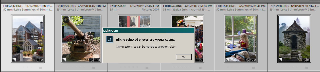

One question: should I be naming the edited catalog the same as the target catalog folder? I've tried moving those virtual images into the desired catalog folder but it says I cannot move virtual copies.
Apr 24, 2019 Apr 24, 2019
You cannot move virtual copies to another folder, because they are virtual. They are not real copies, but just an extra set of edits and metadata. That means they ‘belong’ to the original image, and will always show in the same folder as the original.
When you export as catalog, do you remember to check the option to ‘include negatives’? The negatives are the images, so if you don’t include them with the exported catalog, then Lightroom can’t find them when you import that catalog.

I think you are using the words Virtual Copies for something else. A virtual copy is a Make Believe copy. It does not exist physically. There can't be a Folder of virtual copies. Also virtual copies have a upturned bottom left hand corner.
So I'm not sure what you mean with the words Virtual Copy.

The imported images in the folder do have an upturned corner and since they are virtual copies, it won't let me move it to where the other images are. I've always imported catalogs this way and never had a problem in the past. I am braindead at this point. All my edited work is for naught. All the hours I've spent trying to transfer my edited work, I might have just re-edited them again. This has been so frustrating.

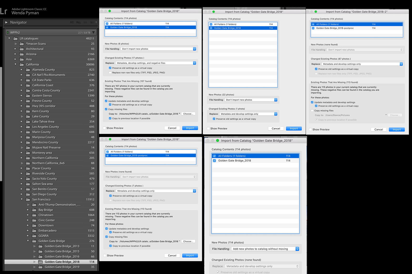

New Here ,
Apr 26, 2019 Apr 26, 2019
Hi, Johan,
I hope you are around. I've tried doing this every which way, but no luck. They may not be in the right order but I labeled them. I even tried starting all over, but in the end, when importing them into my Main LR Catalog it tells me there are new photos, no changed photos and the virtual copies option is grayed out. Anyway, maybe you can see what I am not doing right. But as I said, I've done this before and even wrote up what I do to transfer the edited images and it has always been fine. Here are the posts. It also tells me I have 54 missing previews. I don't understand that either since before I 'Exported as a catalog', I rebuilt both the standard previews and the smart previews. Anyway, I've had to put the screenshots in photoshop since I can't seem to insert as a pdf. Mine aren't png's.
I also didn't use 'Collections'. Just straight Folders with my images. Thanks for your time. W

You can also post too many screenshots. I don’t know which is which, because I see some screenshots that look the same, except for some numbers that Lightroom reports. Perhaps you should post screenshots of one single sequence of events, so we get an idea what exactly happens.
One thing that I do notice is that Lightroom tells you in the import dialog that most of the original images are missing in the main catalog. It tells you it can copy these images from the catalog you are importing. Are the images really missing? You only show the folder panel and not the grid, so I can’t tell...

Hi, Johan,
The only reason I showed all those screenshots was to show that each time I do it, the number of new photos and the missing photos change. As for the missing photos, none of them have question marks on my grid. Anyway, on Monday, I'll start over with another folder (catalog) I have edited when I am fresher. I don't have time this w/e. Thanks and stay tuned. Have a good w/e.

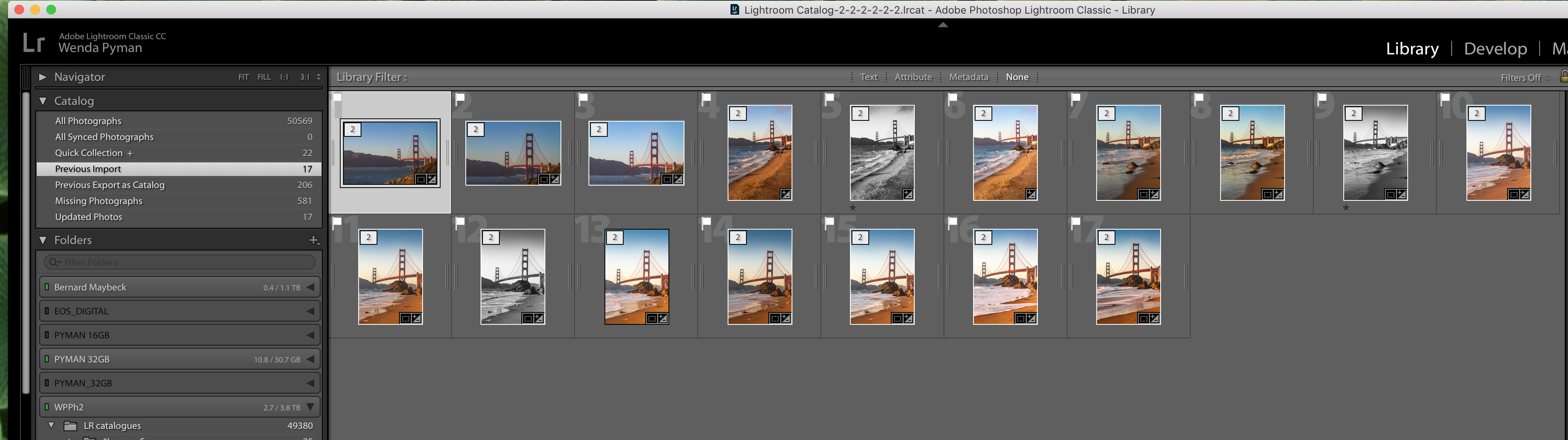

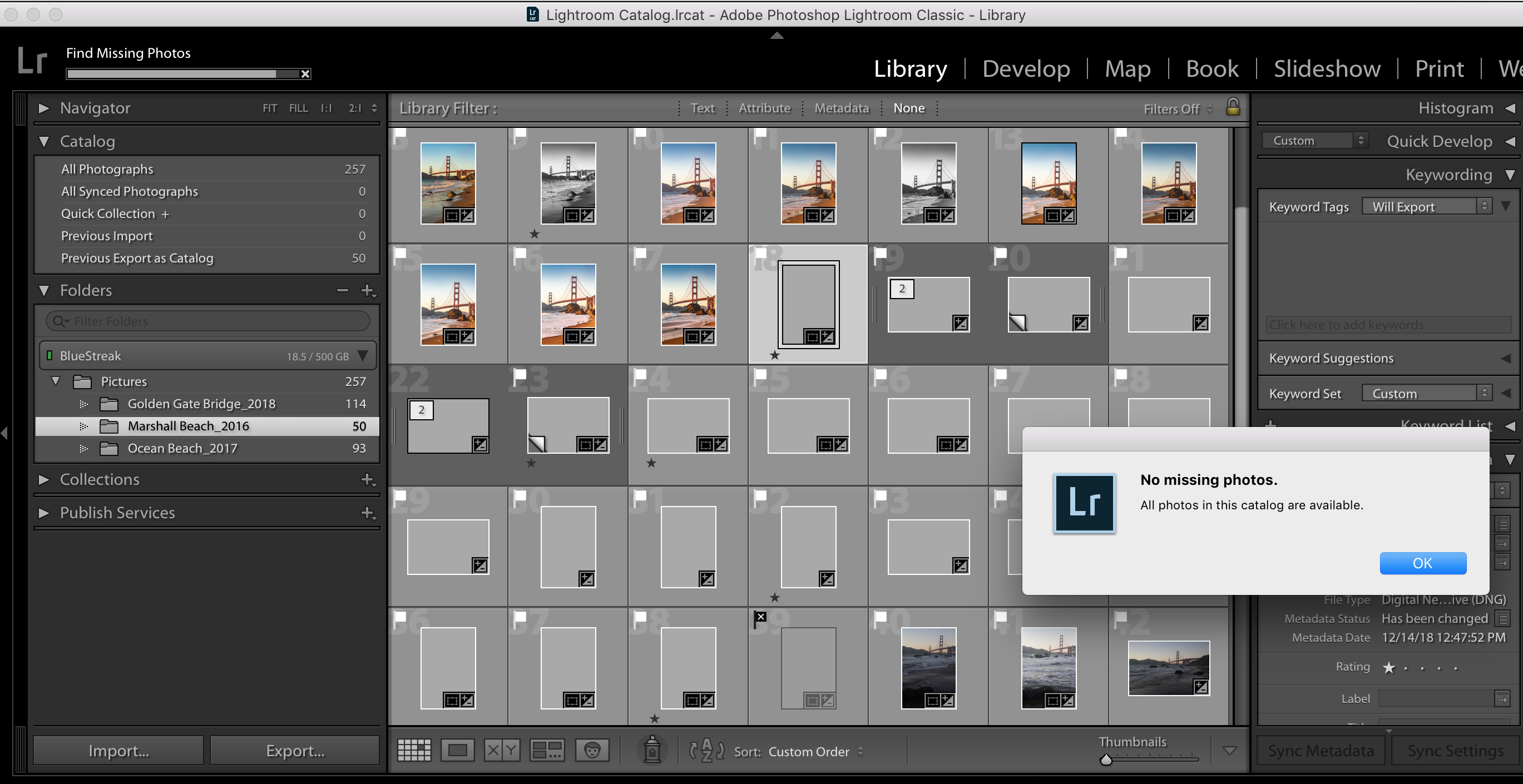

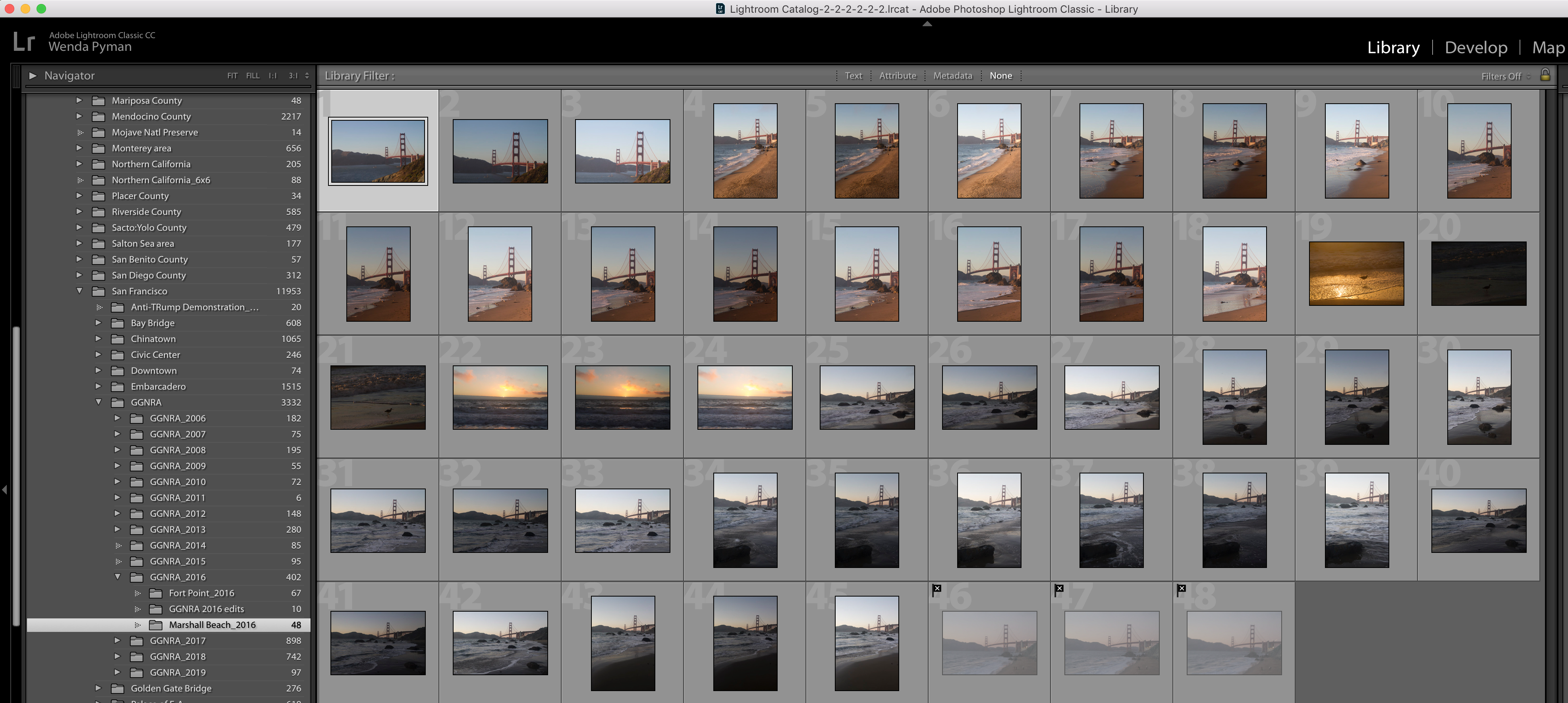

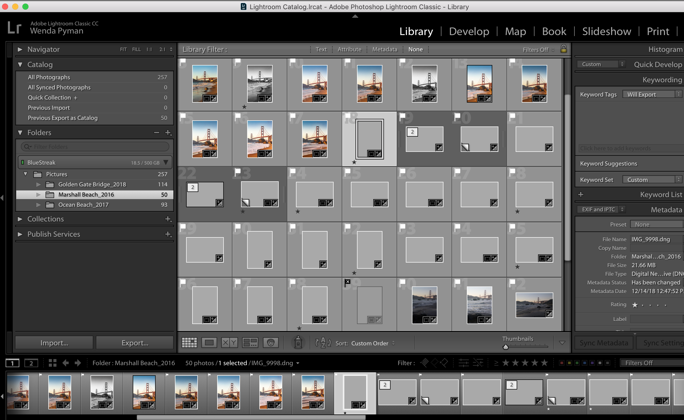

New Here ,
Apr 29, 2019 Apr 29, 2019
Hi, Johan,
This is my last attempt. I've spent so much time on this I could have re-edited these over on my Master LR Catalog! Anyway, I exported as catalog "Marshall Beach_2016" after I rebuilt the previews. 1) On the grid you can see I am missing photos but no exclamation marks. 2) The dialog box also tells me there are no missing photos. 3) This is the Master catalog 4 & 5) Dialog box for "Importing from another catalog 6) shows the imports in the Master catalog BUT they don't show up anywhere in the catalog itself. When I tried to move it to the proper folder, it tells me the images already exist at that destination (Marshall Beach_2016) and could not be copied. So no edited images shows up in the Master catalog folder. The images that did transfer to the 'Previous imports' are the edited versions. So, where did they go? I have numbered the screenshots and also titled them. Is there some path that is screwed up?
1) 2019-04-29 at 2.02.03 PM_Grid.png2) 2019-04-29 at 2.04.12 PM_No missing photos.png3) Master Catalog folder.png4) Importing from FlashDrive.png5) Dialog Box when Importing catalog.png6)Photos that imported.png
Apr 30, 2019 Apr 30, 2019
The grid does not show missing photos, but it shows missing previews. Your preview cache may be corrupt. Try the following. Open the catalog folder and remove the ‘Lightroom catalog previews.lrdata’. Then start Lightroom again. At first you will see no previews at all, but then Lightroom will start to rebuild them and so they will show one by one. Maybe this will also solve that problem during import...
