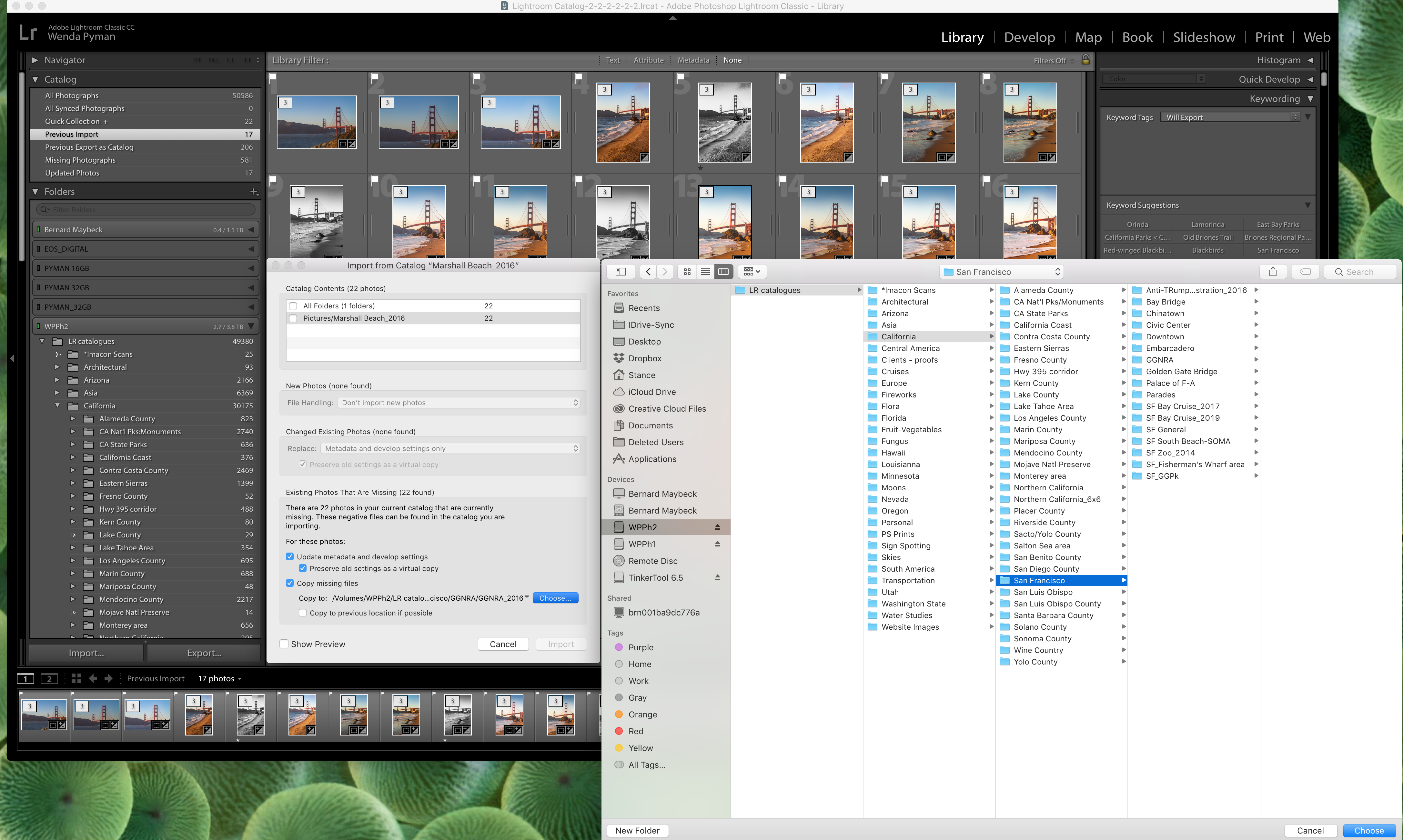

I'm going to pull my hair out. In the past, I would export unedited folders from my main LR catalog to my Macbook and edit them while I am away. When I return home, I 'export as a catalog' my edited images to a flash drive. I then 'import from another catalog' to my iMac LR catalog. I've always done this in the past and never had any problems. My imported edited images would show up and the old settings would show up as virtual copies.
Lately, I followed this same workflow but no matter what I do, it doesn't work. I get as far as the 'Import from Catalog' dialog box showing the catalog contents but it won't let me check off the folder that I want to import. Also, it won't let me change the existing metadata and develop settings (grayed out) I have spent countless hours trying to do this every which way but nothing works. What has changed, or what am I doing wrong? HELP!!

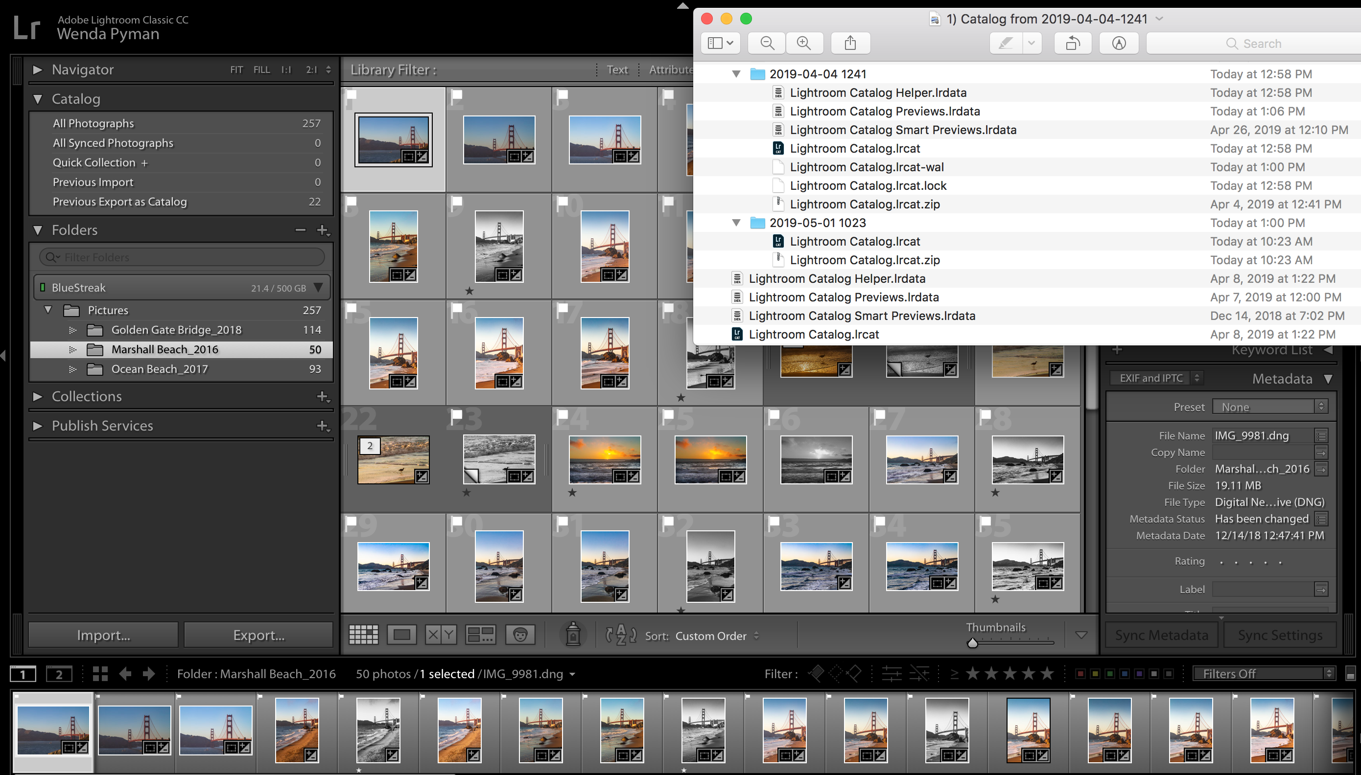

Hi, Johan,

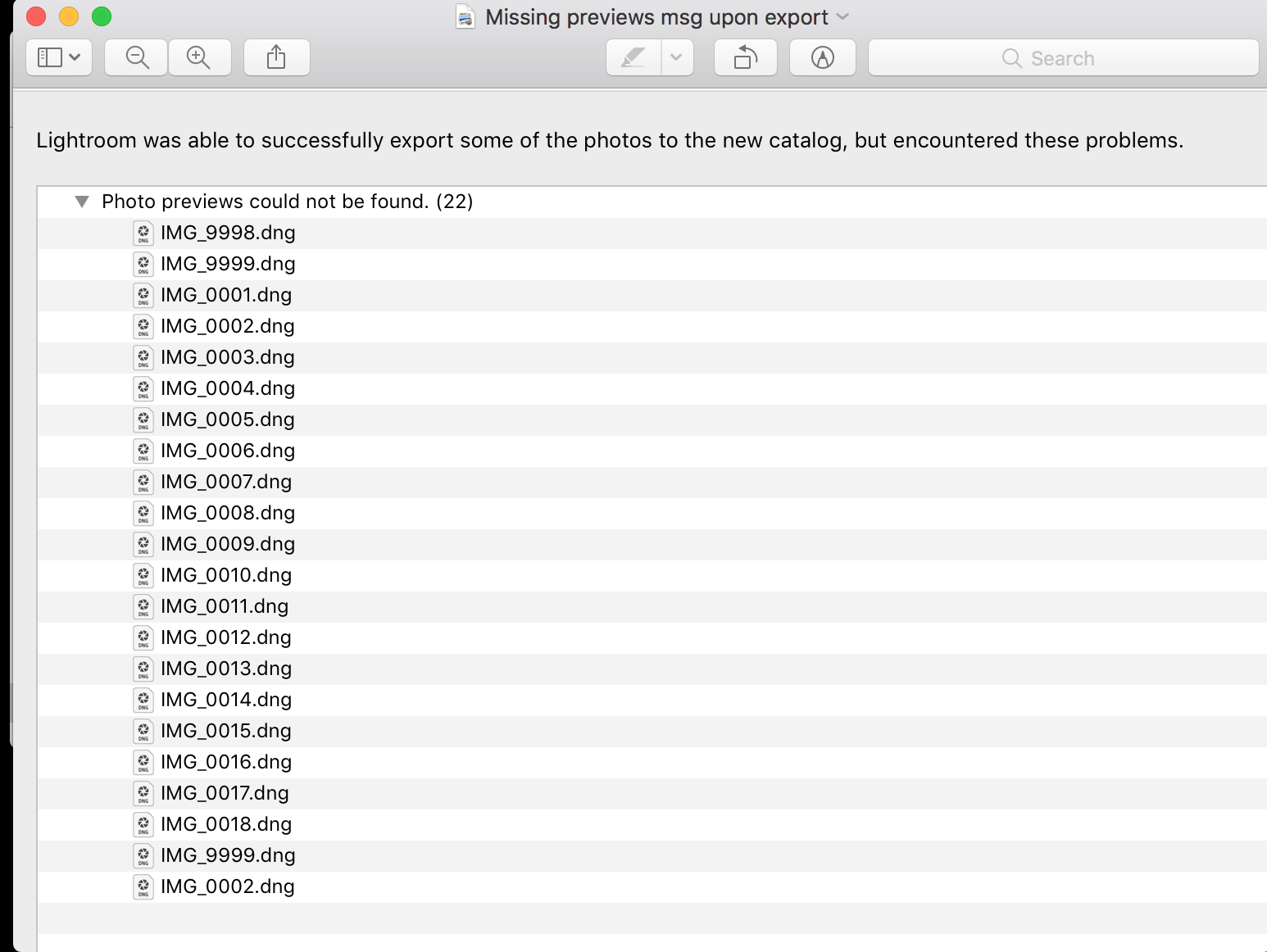

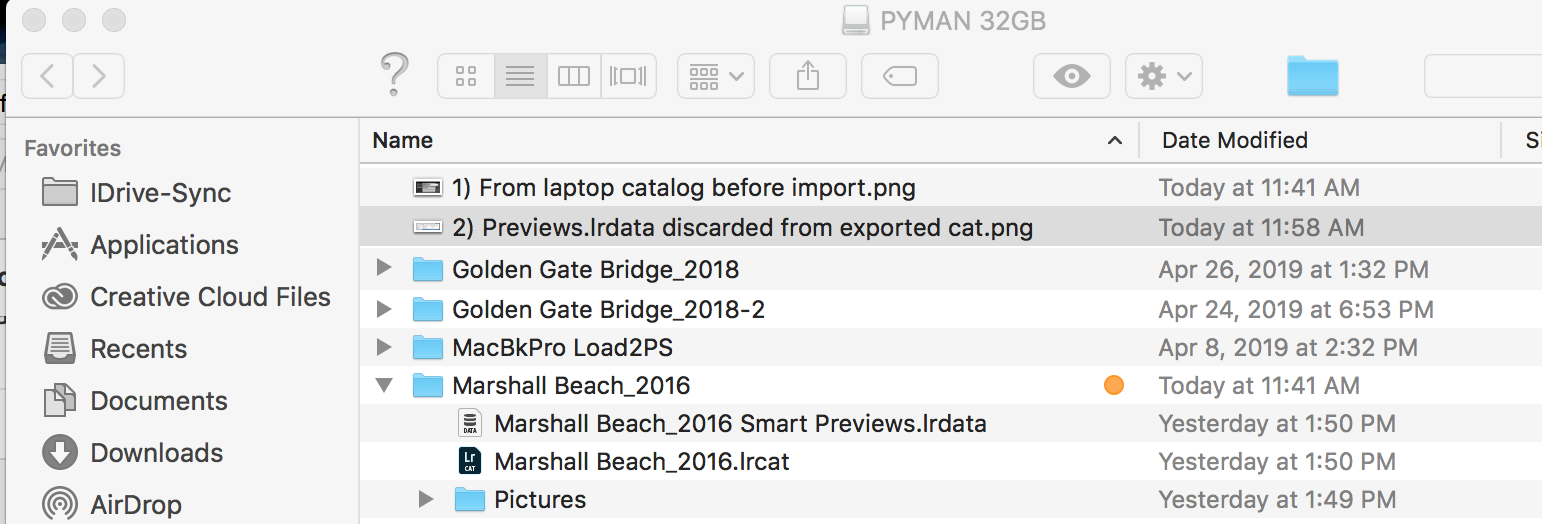

I exported as catalog to my flashdrive, then discarded the previews.lrdata, as you recommended. Received a msg saying that 22 previews in this catalog are missing. Mind you, I have 50 photos in this catalog. I then carried this flash to my iMac & WPPh2 drive, chose 'import from another catalog. A dialog box opened showing the catalog but this time 22 photos BUT, it doesn't let me check off the folder so 'import' stays grayed out. However, I can't seem to change it. The last image is what I see in LR on my laptop. As you can see, there are supposed to be 50 images but the previews are missing.

First of all, I think there may be some miscommunication. I got the impression that your main catalog (or at least the catalog you exported from) did not show all previews. That is why I recommended to let Lightroom rebuilt the previews cache of that catalog. A freshly exported catalog should not have such a problem, so it was not my intention that you removed the previews of the exported catalog.
I'm also very puzzled about your screenshots and what you say about them. The first screenshot shows that Lightroom could not find previews of 20 images during export. And your second screenshot shows that the Marshall Beach subfolder contains only these same 20 images. Then you say "Mind you, I have 50 photos in this catalog". So what catalog is that? It's not your main catalog (shown in your third screenshot, I assume?). Or do you confuse 'catalog' and 'collection' and did you mean to say that there are 50 images in the collection you tried to export as catalog? Your fourth screenshot does indeed show yet another catalog that contains 50 images in that subfolder, and contains two more subfolders with 257 images in total! And this catalog has a problem with previews. What am I looking at here? You have completely lost me.

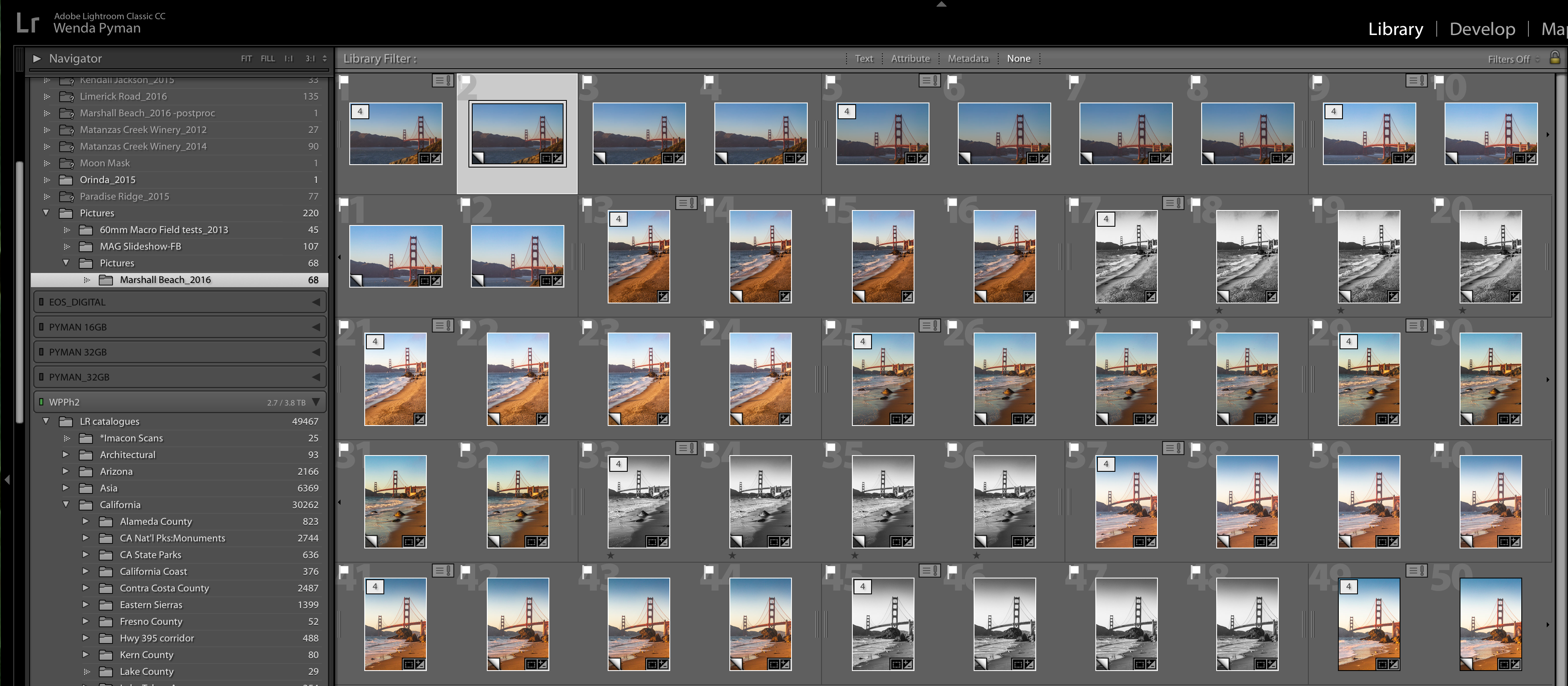

I'm getting confused too. However, I know I'm definitely working with a catalog and not collections. The Previous screen shot (grid) shows my missing images out of the 50 (above your last thread). That's on my laptop.

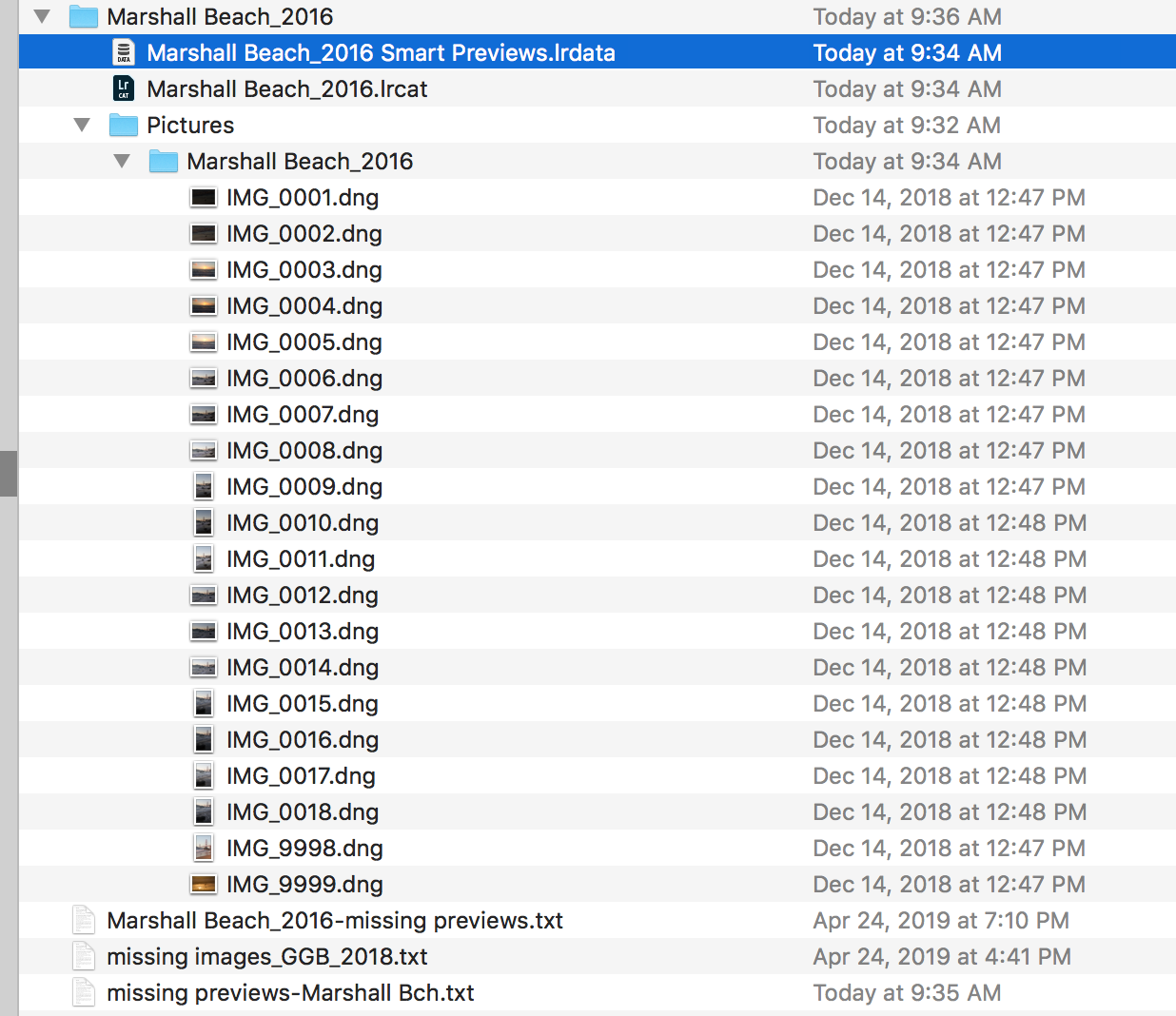

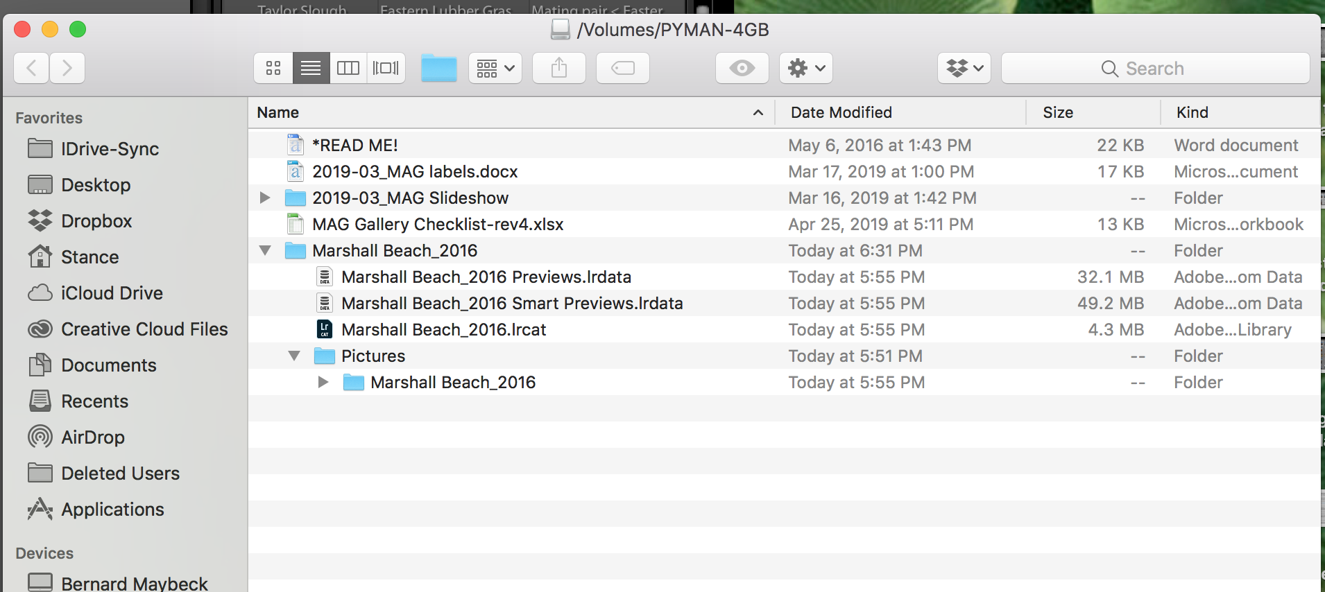

I exported 'Marshall Beach_2016' as catalog to a new flashdrive from a previous LR catalog backup (on the laptop). The lrcat previews were there along with the photos. I then 'imported from another catalog' from this flashdrive to my Master Catalog (WPPh2) tethered to my iMac. A dialog box came up saying I had 49 changed photos (correct!) and 'replace metadata & develop settings, preserving the old settings as a virtual copy. (Screenshot 1)
It also said that 33 photos were missing so I copied missing files to my WPPh2 Master catalog. (Screenshot 2)

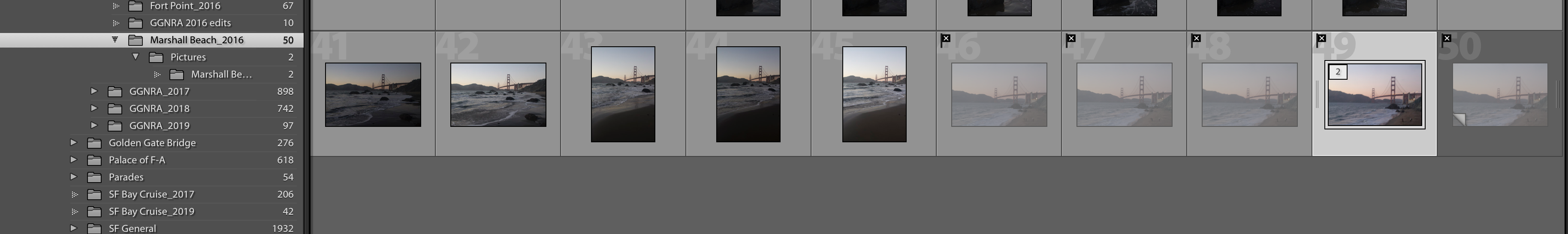

Then I imported then and the edited versions DID show up along with virtual copies as they should. However, the first 17 images, which yesterday imported and showed up as 'previous imports' and then didn't end up in my Marshall Beach folder did not import this time with the batch. (Screenshot 3).

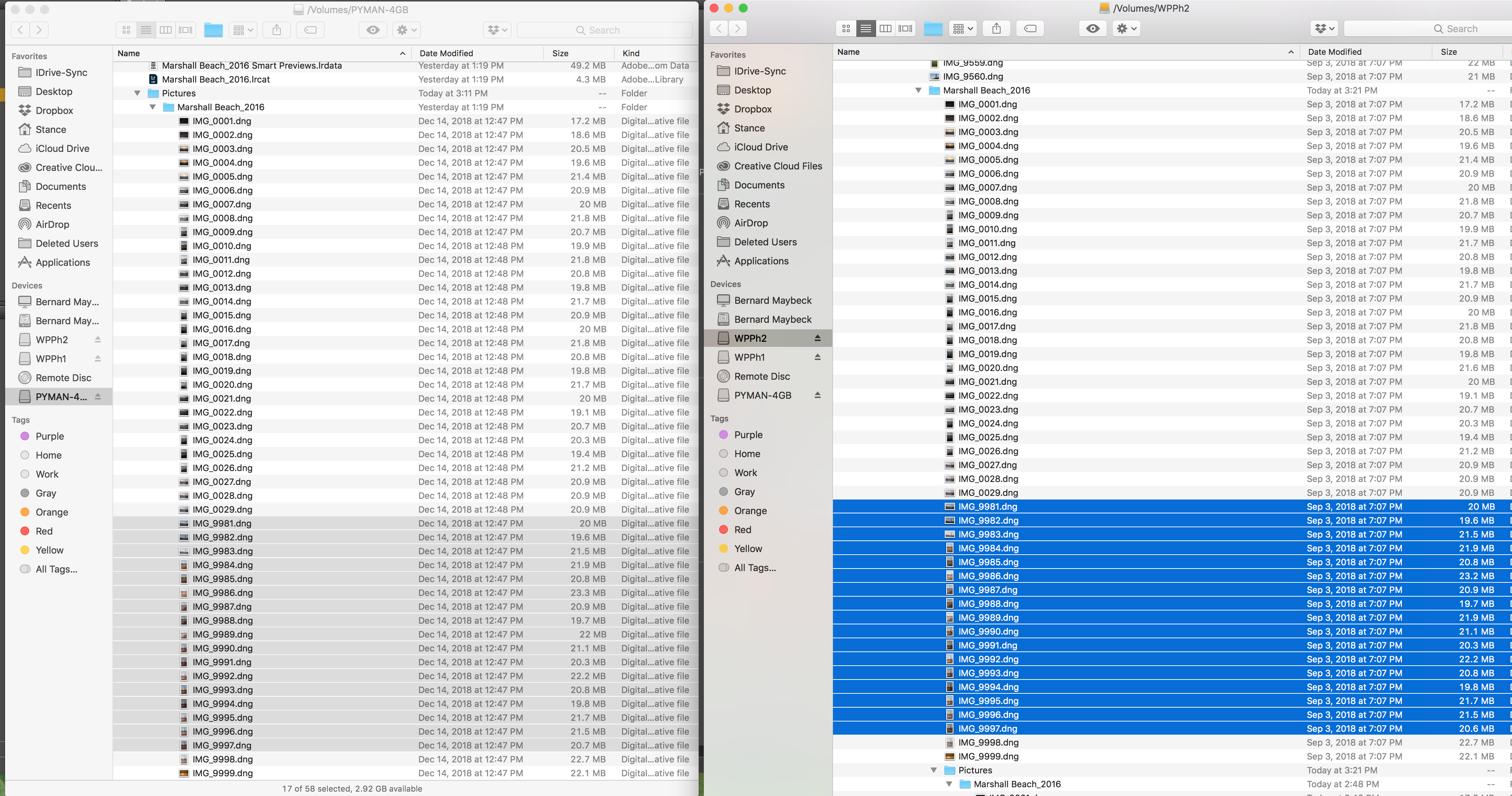

When I go to the WPPh2 catalog itself, I can see the photos that were copied and put into another Pictures folder. The ones on the flashdrive that are highlighted are the ones that didn't copy to this new Pictures folder. The original images right above that are complete (screen 4)
Can I just physically take those missing images (from the flashdrive) and drag them to the Pictures>Marshall Beach folder or will that behind the scenes move totally confuse the LR software? thanks, W
Sorry, but I don’t understand what you are saying here and the screenshot does not show me anything. I see a folder with a bunch of highlighted images, and I see a catalog that does not show anything useful. You imported these photos yesterday in which catalog? And what is the exact problem now? Did you edit these and do the edits not create virtual copies? You only get virtual copies if the photos have previous edits. If they don’t, then you won’t get virtual copies.
Copying photos to a folder will not confuse Lightroom. However, depending on the situation you will see the one of the following:
1: If these photos are in the catalog (but shown as missing), then copying these photos will make Lightroom see them and so they will no longer be marked as missing.
2: If these photos are not in the catalog, then copying them to the folder will not make Lightroom do anything. Lightroom won’t know the photos are there and they won’t show in the catalog.
Again: You will have to ask yourself first why you would need to copy these photos in the first place. They are in the exported catalog, which means that these photos were not missing when you created that catalog from the backup. That means they must be somewhere on your main photo storage already. They are just in a different place than where your main catalog thinks they should be.

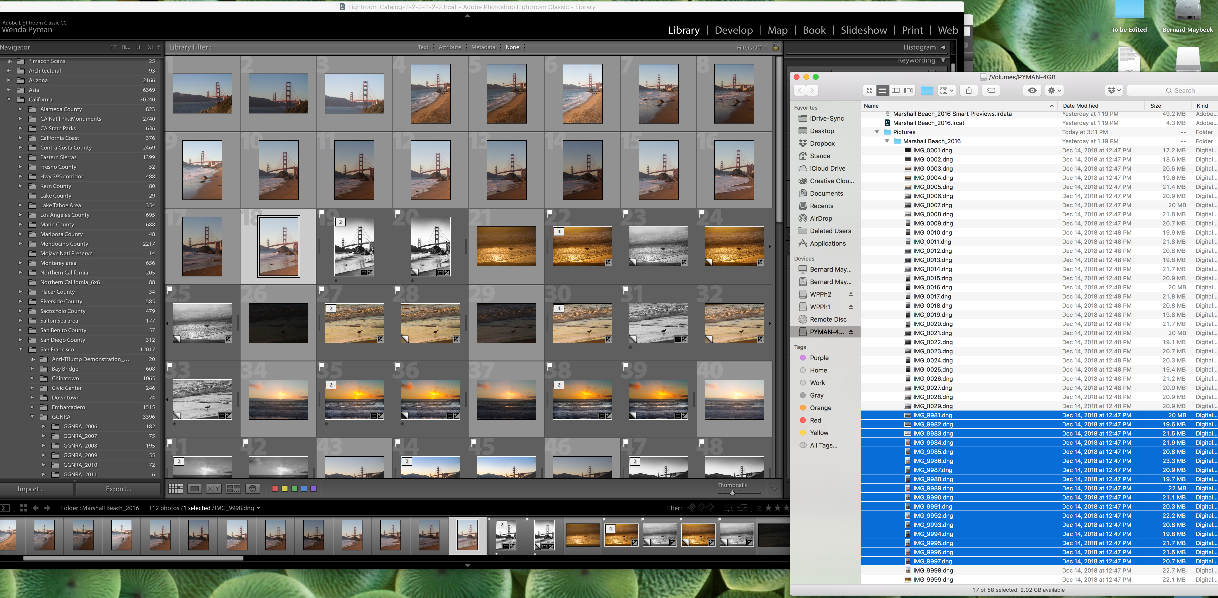

Good morning, Johan. You're right. Copying the missing images to the last export folder did nothing. I did locate the missing edits in the Updated folders of the Master Catalog but don't know how to move them to the Marshall Beach folder.
You can see the the images (highlighted) that missing edits (below).
I've tried all your recommendations, starting from scratch and using different flash drives, etc. I've rebuilt previews before exporting as catalog, etc. Still scratching my head.

I'm sorry, but I still don't understand what you are trying to achieve. You say "I did locate the missing edits in the Updated folders of the Master Catalog but don't know how to move them to the Marshall Beach folder." What does that mean? Do you tink you can move edits somehow? Or are you still trying to move virtual images to another folder (something we explained earlier you cannot do)? It sure sounds like it...
The first screenshot shows only virtual images, in a collection. I would think that the second screenshot shows the original images, located in the 'Marshall Beach' folder, but I don't see any virtual images next to these originals. Normally they would be right next to their original, and stacked with that original. That is the default. It's possible they are simply further down or up the grid, and not shown in the screenshot. That could happen if they are not stacked, and the sort order separates them from the original. Because you cut off that part from the screenshot, I can't see what the sort order is, so I don't know if that is the explanation. It does make me wonder if you perhaps have duplicate images in the catalog, however.
Maybe you can check that as follows. Select one of the virtual images in the first screenshot, and then choose 'Photo - Go to Folder in Library'. Which folder does Lightroom select now?

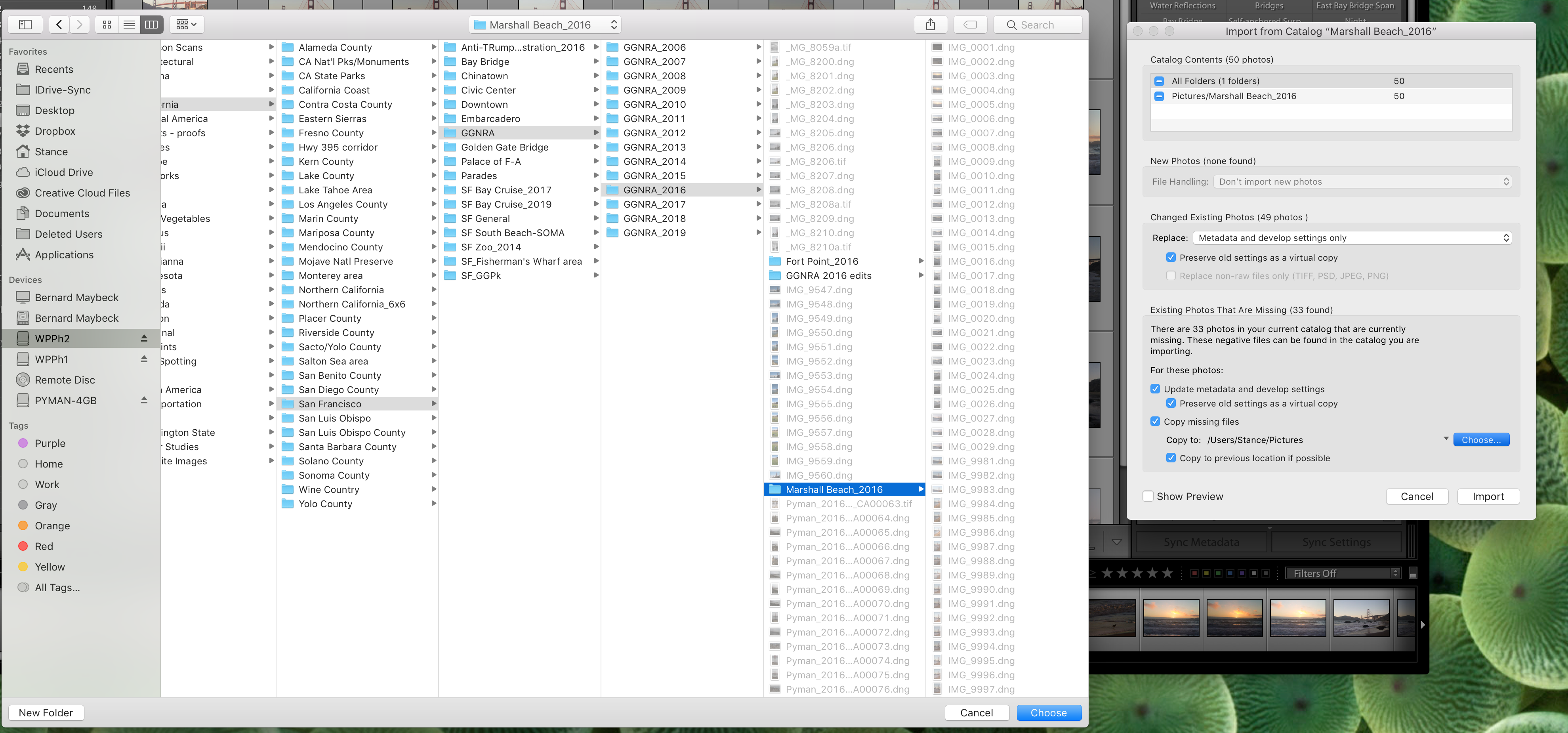

I then went to the iMac, choose 'import from another catalog' and the dialog box told me I had 49 new photos (Not!) and only 1 changed existing photo. It also said it would copy the missing files to my Master Catalog (WPPh2). Screenshot2.
Instead, it created another subfolder (Pictures>Marshall Beach_2016) and imported 2 virtual copies. and this is what showed up (screenshot 3)
The imports were rejects in the edits. The other thing is that when I 'Export as catalog' the folder shows the lrpreviews, smart previews, lrcat and another subfolder 'Pictures' with another Marshall Beach folder with the photos. Then, after import, in the Master catalog it shows up as subfolders as well when I want it to be in the main (root) Marshall Beach_2016 folder. I tried moving the images out of Pictures and just put the images loose in the import folder and that didn't work either. I still get the same dialog box and same virtual copy that I don't want.
In the past, the imported, edited photos always end up in the top folder of the same name and doesn't create subfolders. So...any thoughts? Thanks for your patience.

So, first thought: don't check the option to import missing pictures if these are rejects!
Second thought: I did a quick test and exported some photos as catalog. The images are stored in their hierarchy as expected, meaning you will only get a 'Pictures' top folder if the images are in a 'Pictures' top folder in the main catalog as well.
Third thought: If you do import missing or new pictures, then be aware about the folder structure that Lightroom will import. In order to make your pictures appear in the correct folder, you have to select the same top folder in the dialog. That folder does not exist however, because of the way you are testing (see below).
Fourth thought: The problem is the way you are testing. You export images as catalog from some test catalog that contains only 257 images and has an entirely different folder structure than your main catalog. When you import this exported catalog into the main catalog, Lightroom cannot match the folder structures and that is why new images get imported in a different folder than what you want. It probably also explains why rejected images are seen as new and will be imported. If you want to test this properly, then export some images as catalog from the main catalog, make some edits in this exported catalog and then import this catalog again in the main catalog.
