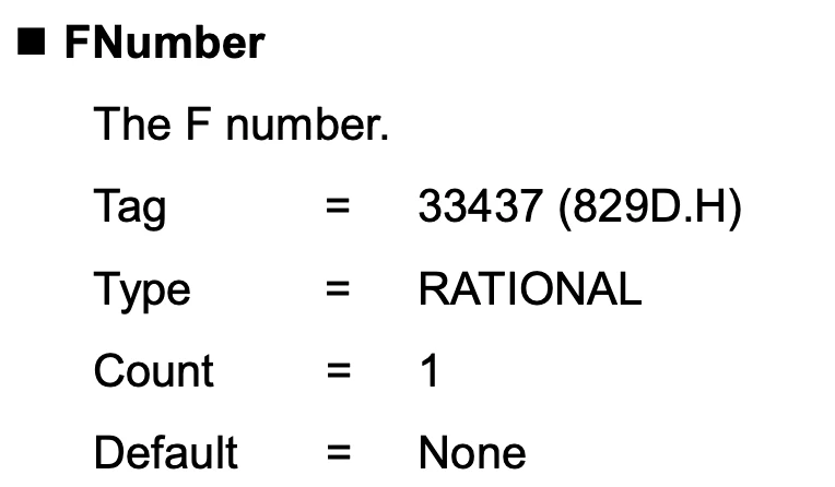

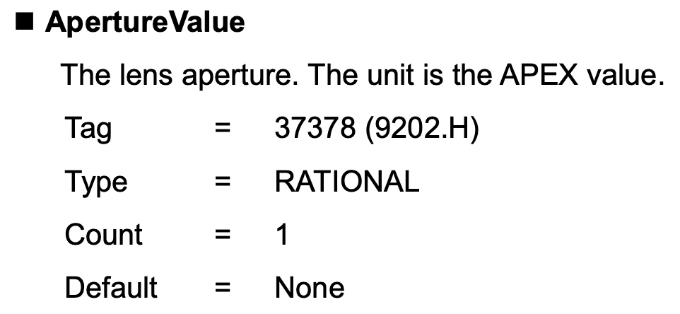

The Exif standard defines two fields, FNumber and ApertureValue:
FNumber is the traditional f-stop, e.g. 2, 2.8, 4, 5.6, 8, etc.
ApertureValue is the f-stop expressed in APEX units.  Annex C of the standard explains APEX is the Additive System of Photographic Exposure, in which:
ApertureValue = 2 * log2 (FNumber)
(Given two f-stops, the difference in their ApertureValues is the number of stops between the two. For example, f/8 is four stops away from f/2 (f/2, f/2.8, f/4, f/5.6, f/8), and the difference in ApertureValues of f/2 and f/8 is 4.)
So according to the standard, FNumber and ApertureValue should always represent the same measurement of the lens opening, just in different units. Both those numbers are represented as "rationals" (a 32-bit numerator divided by a 32-bit denominator), more than enough to provide at least 16 decimal digits of precision when converting from one unit to the other.

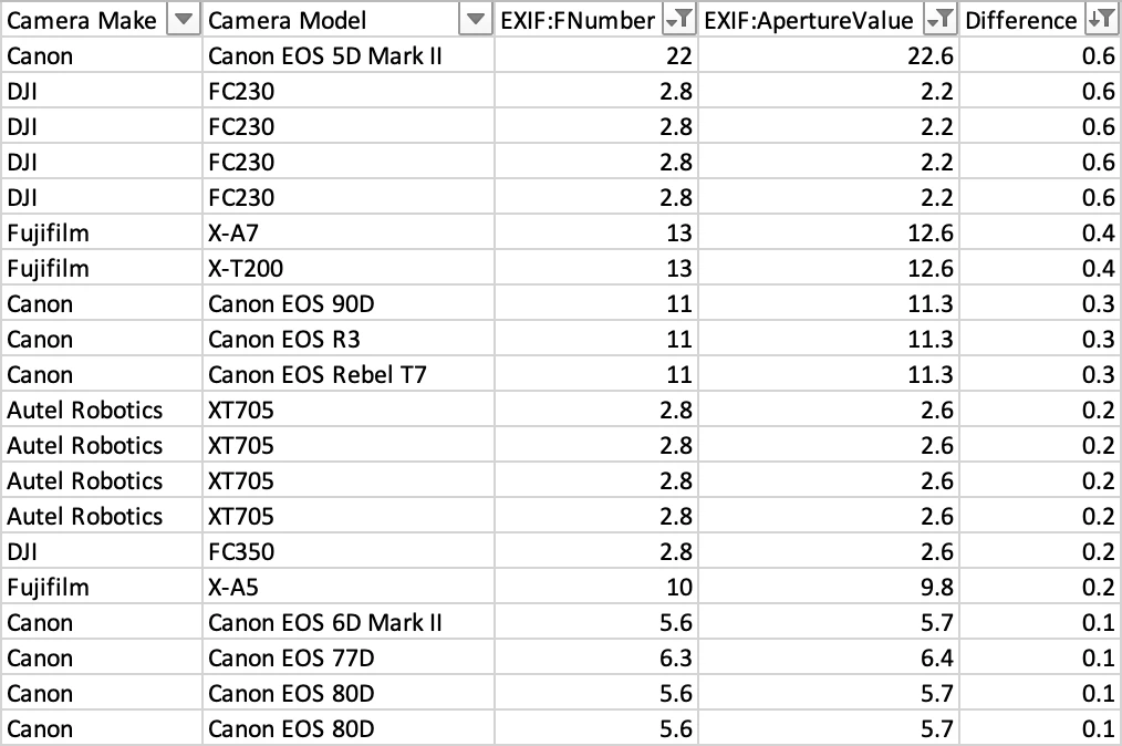

But in practice, it appears that many cameras record different equivalent values for the two fields.  I've got a test catalog with 714 raws from 22 camera makes and 260 models. Using the Any Filter plugin's Sort command, I exported a spreadsheet of file name, camera make and model, EXIF:FNumber and EXIF:ApertureValue, the latter arithmetically converted to f-stop units:
f-stop = (2^ApertureValue) ^ 1/2
I've attached that spreadsheet here. (Open it in Excel or Google Docs.)
Many cameras record FNumber but not ApertureValue including models from DJI, Haselblad, Leica, Nikon, Olympus, Om Digital Solutions, Panasonic, Ricoh, Sigma, Sony.  For these photos, LR's Metadata panel displays FNumber for F-Stop and Aperture.
A few cameras record ApertureValue but not FNumber, including five models from Leica and one from Sealife. For these photos, LR's Metadata panel displays ApertureValue converted to f-top units for F-Stop and Aperture.
Of the 347 photos that record both fields (out of a total 714), 92 record different aperture measurements, e.g.
These differences aren't caused by the different units used to store the values internally in the EXIF -- as mentioned above, 64 bits are used to represent each value, more than enough to get many more than 3 digits of accuracy in the conversion.
For all 92 photos recording different values for FNumber and ApertureValue, the Metadata panel displays FNumber for both F-Stop and Aperture, ignoring the different ApertureValue.
