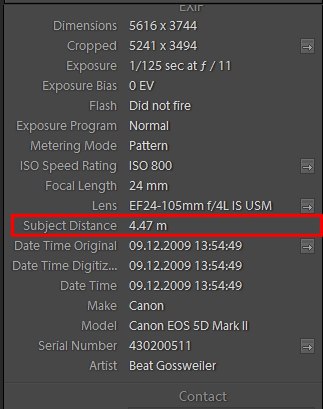

People's Champ ,
Aug 12, 2010 Aug 12, 2010
areohbee wrote:
I've never seen "Subject Distance" anywhere in Lightroom - too late for me to test 3.0 - don't suppose I could trouble you for a screenshot just to satisfy my curiosity, eh? Its OK if you don't want to bother...
PS - I believe you - its more of a sanity check for my self.
Rob
Here you go:
But its presence has been dependant on Camera and/or Lens model.
Beat Gossweiler
Switzerland
LEGEND ,
Thanks Beat,
Interesting that I never noticed it that I can remember, and that it slipped through a crack in 3.2RC
R

LEGEND ,
In LR3.0 I had created a Print module Photo Info preset with the Subject Distance tag and the information still shows up on my prints using that preset; however, if I edit the preset in LR3.2RC, it does not show the tag, anymore, so I have to hack the text-file containing the preset to put it in if I still want it:
My LR3.0 print-info template C:\Users\Steve\AppData\Roaming\Adobe\Lightroom\Text Templates\Everything.lrtemplate contains this notation that represents subject distance:
value = "com.adobe.subjectDistance",
Looking at the values reported for my Digital-Rebel XSi and kit lens, it is clear these values are very approximate, where during an indoor photoshoot I only have 1.45m and 3.49m reported for subject distance despite being various distances from my subjects.
I expect that after seeing all the confusion and questions about this value when shown to the user, LR3.2 hides it, and only uses it for matching lens-corrections by distance.
LEGEND ,
Aug 13, 2010 Aug 13, 2010
Eric Chan once wrote me about this in a private email (when we were debugging some lens correction issues in ACR 6):
(Just FYI: Nikon cameras record two types of focus distance & position info. First, there is an indication of the general lens position, which is pretty coarse. There is a particular set of bits set to zero if it's infinity focus. Then there is another value that records the estimated focus distance. This is somewhat arbitrary in the case of infinity focus. exiftool is aware of both of these, but will still report a "meter" value for the focus distance, even if you have the lens at infinity focus.)
That might be the case for Canon cameras too.
Explorer ,
You are correct. Looks like they took it out. It was in the Beta and in 3.0. However, the values were bogus most of the time. Infinity was displayed as some redicilous number for example.
