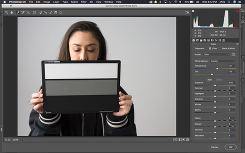

Rikk - I'm seeing the same behavior if I shoot in 'Daylight' WB set in-camera. When that RAW file is imported into ACR it ends up cooler and with too much magenta every time.
Adobe ACR shows 4650 K +17CC if I set the WB in-camera to Daylight
Adobe ACR shows 5500 K +10CC if I set the WB in ACR to Daylight
The images are visually different, with a cool magenta color cast on the image where daylight WB is set in-camera.
So the WB tags from the camera are either wrong, or the WB tags are being incorrectly mapped in ACR.
Either way it's a big issue.

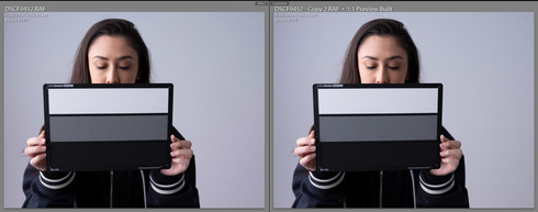

NOTE: I'm still seeing a WB difference between Lightroom Classic 8.2.1 Library and Develop modules with just a Standard Preview built. Once a 1:1 Preview is built the Library module preview matches the Develop module and the rendering in ACR. Why just the Fuji GFX files exhibit this is a mystery. However, it's a separate issue specific to Lightroom that Adobe Engineering needs to investigate.
Lightroom Classic 8.2.1 Library module
    STANDARD PREVIEW BUILT                   1:1 PREVIEW BUILT

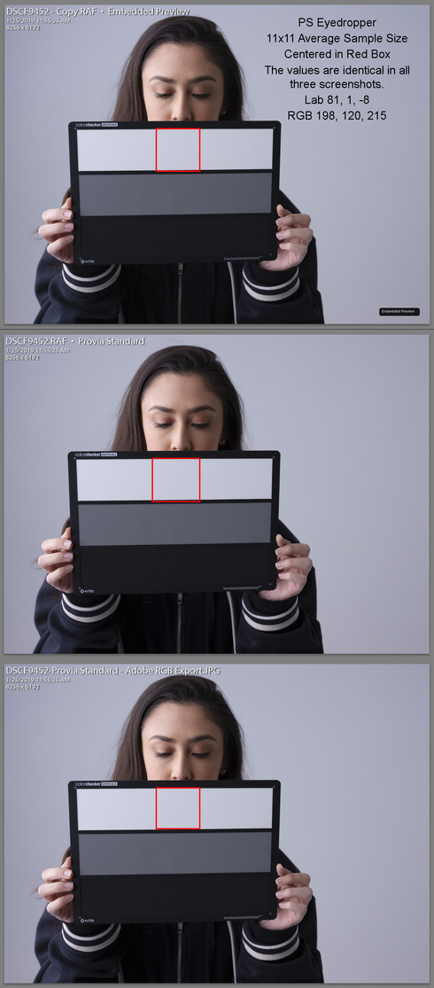

Chris, I can easily see the WB difference between this JPEG and RAF file pair. Thinking about this it may have something to do with the in-camera crop setting. You mentioned that when a crop is set the camera creates both an RAF file and a JPEG, even when the camera is set to raw only. Perhaps the JPEG created with in-camera crop is applying WB differently.
Here's a GFX 50R raw+JPEG file pair from Imaging Resources. With the As Shot WB and camera profile Provia/Standard applied the WB in the ColorChecker is correct and the same in both the RAF and JPEG file. The only difference here is that an in-camera crop hasn't been applied. There may be some other in-camera settings as well, but I haven't examined them. The color rendering is also near identical with some slight differences in saturation.
Plese let me know if you're seeing something different when viewed on your system with the As Shot WB and camera profile Provia/Standard settings in ACR.

I'm only seeing a 1 unit Tint or Temp difference between your raw and in-camera JPEG, but even the 2 unit difference in your screenshot is very small. I know you mentioned that this is happening with all Adobe camera profiles, but it's important that we compare the same in-camera to ACR settings. To do that you need to set the camera to Adobe RGB and Provia/Standard so that the JPEG has these settings applied to it. We can then set the raw file to Provia Standard camera profile to match the JPEG in-camera rendering. That's what I did in my screenshot showing the Embedded Preview, RAF file, and JPEG export of the RAF file. In my composite shot there is 0 difference in Temp and Tint.
The larger WB differences in the 2nd picture of the motel may be due to other in-camera settings. Many in-camera settings are not read or applied inside ACR/LR, which can cause significant difference in the raw rendering compared to the in-camera JPEG file. These raw to JPEG differences can also be caused by an incompatible monitor profile.
Given these small differences the best way to determine what's happening is to do a controlled test shot of the ColorChecker Grayscale card. Set the camera for Adobe RGB, Provia/Standard picture, Highest Quality Full-Size JPEG, and all other picture style controls set to 0 or OFF. This will most closely match the RAF file rendering inside ACR/LR when it is set to Provia/Standard camera profile. It would also help to set the camera's WB as close as possible to the actual lighting condition. Then post the raw+JPEG file pair to Dropbox for comparison. This will help us both to determine what's wrong and get it "fixed." Thank you!

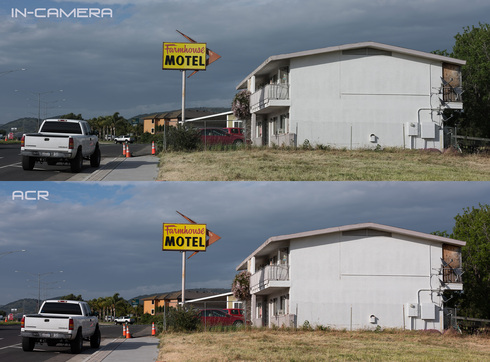

Here's a good example where I'm having to shoot RAW + JPEG in order to do the in-camera pano crop. You can see the ACR version has more magenta, neutrals like the sidewalk go magenta in color for example.
