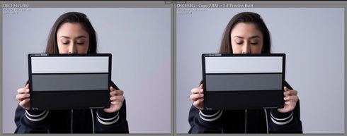

Let's focus on the actual screen rendering and not the WB values for now. The amount of "actual" WB shift in the image rendering is small compared to the large differences in As Shot WB readings. It's indicative of an issue, but not the problem we need to identify and nail down right now.
Let's address this question, "Given that I'm having to explain the above to you - can I ask what your qualification is to be reviewing this issue?"
I am not an Adobe employee and assisting you as any other user would in this forum. Adobe has assigned some of the more experienced users the title of 'Champion' with ability to edit and move posts as well as communicate directly with Adobe staff. My statement, "I have no idea how LB and CC values are converted to the single Tint value" is in reference to how Adobe converts the raw file's WB matrices to 'As Shot' values, regardless of how they are set in-camera. I established my own color processing lab back in the 1970s and certainly know what CC filters are and how to use them.
In my last post concerning the Studio sample RAF file, "Does that concur with what you see in the Studio sample file DSCF9452.RAF?" If not tell me what you are seeing in the actual screen rendering not WB values.
After looking at this further I discovered building a 1:1 Preview for the DSCF9452.RAF file (Library> Previews> Build 1:1 Previews) removes the magenta tint shift observed in the lower right and left gray background area. Do you see that as well when viewing the image in the Library module? If not 'Remove' the file from LR and reimport it with 'Standard Preview' selected in the Import module 'Build Previews' selector. This is not normal behavior so I need to confirm you are seeing the same behavior...or not! I tried disabling 'Use Graphics Processor,' but it had no affect on the magenta tint with only a Standard preview built.

I'm worried by your use of the term 'identical' - the two versions are not identical, and the magenta cast is visible on the backdrop, model, grey card etc - the skin tone is a dead giveaway. Do you not see that?

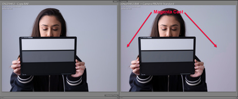

Apr 17, 2019 Apr 17, 2019
BINGO–Your Studio sample - GFX50S RAF file really demonstrates the issue!
The embedded preview and LR raw file renderings are identical, but the backdrop shifts to a magenta tint in the lower right and left sides of the image. I used the PROVIA/Standard camera profile, which best matches the embedded preview rendering. As you mentioned all of the camera profiles exhibit the issue. Thanks for hanging in there with me to establish something Adobe can evaluate and fix.

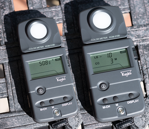

The color meter CC (Color-Correction) displays Kodak filter number(s) of the necessary light-balancing filter(s) to make for easy selection of the required light balancing filter. Whereas the LB system uses amber or blue filters, the CC system uses magenta or green color compensating filters. CC is the system Adobe represent in ACR, so you only have to use the CC value from the meter.

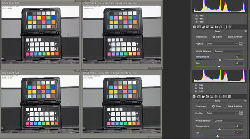

My in camera JPEG and ACR JPEG are also different, _ measure CC3 difference in mid grey, CC10 in dark grey/black
Community Beginner ,
Not only can I see a difference between the embedded JPEG and the ACR JPEG, I can measure it. Top set WB off of your RAF, bottom set WB off of Embedded. There's a CC5 difference.
And I'm using PS not LR

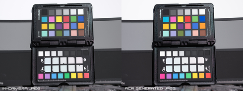

Both RAF file's embedded preview and raw file have identical WB rendering with 'As Shot' WB when viewed onscreen and using the WB Eyedropper. I just noticed your post showing the in-camera JPEG next to an ACR generated JPEG also look identical. Are you not seeing that? If not we need to do some troubleshooting.
Do the RAF files look different when switching between the Develop and Library modules? If so try unchecking 'Use Graphics Processor' in LR Preferences> Performance tab. Do they now look the same?
LR As Shot WB Values: 5050 +17 and 5000 +17
Your meter WB: 5080 LB -10 CC 3
 I have no idea how LB and CC values are converted to the single Tint value, but it's of little concern since the actual WB rendering is correct. I also checked LR JPEG file exports and they look identical as well.

Metered K and CC values

The in-camera JPEG shows accurate WB, while the RAW conversion of the same file in PS shows a -k and +CC WB shift. The ACR WB shift is not dependent on any Adobe profile used, it exists on all Adobe color profiles, including the camera specific ones.

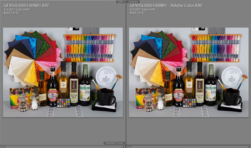

As already explained differences in LR WB Temp and Tint "values" are very common and not necessarily a cause of incorrect WB. The best way to determine if LR/ACR is reading and setting WB properly is to compare the RAF file's embedded JPEG preview (or an actual raw + JPEG shot) with the LR rendering of the raw image data. Below is an example using the RAF file at the link I provided.  There are slight color differences, but the WB is identical in both the embedded preview and raw data rendering in LR 8.2.1.
If you have a file that demonstrates a WB difference between the embedded JPEG or camera JPEG and LR raw data rendering then we have something for Adobe Engineering to investigate. Thank you.
