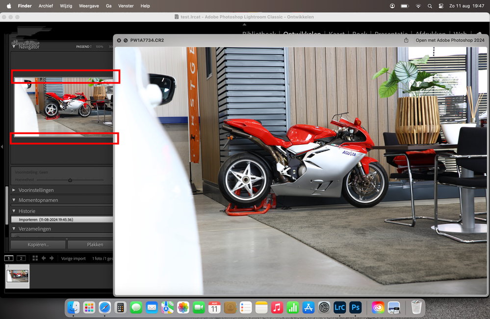

when i put my photo in Lightroom the standard size of my photo is 5760x3840. Sinds today when i try to edit the photos it cuts the photo above and under and the size is now 5760x3240. And the strange thing is that is only the half of the pictures has this problem
in the Lightroom navigator where you can see the photo preview its also cropped. The strange is when i open the photo on my MacBook air the size of the photo is correct, 5760x3840 but when i open it in photoshop or Lightroom classic it cuts the photo to 5760x3240.

i will show it you with some pictures. I always shoots 16:9 and if i go to photo info i see 5760x3840
Then explain me why when i open the photo on my macebook the size is correct, and when i want to open the photo in lightroom or photoshop its crops up and down to 5760x3240?

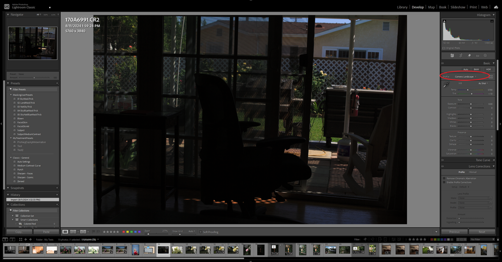

So, returning to the discussion. After charging a battery, setting my 5D Mark III Aspect ratio to 16:9 ( and yes it was in the default 3:2). taking a quick shot, and importing into LrC. this is what I see:
5760x3840
Oh, and a full screen in the Develop Module, Notice the Profile, an Adobe default (in case you are wondering about the LrC /Preferences/Presets/ Develop RAW default/ as in Adobe Default
After accomplishing that, it occurred to me that I was using Adobe Defaults for the Develop RAW setting, and what if I selected the Canon 5D Marks III. Not an issue, I had an additional (even uglier) test shot. So I set the LrC /preferences/Presets/ appropriately, closed LrC, opened LrC, imported another test. But the Aspect Ratio in camera did not transfer.
I you can see that the in camera setting for Picture Style (Landscape) got brought over into LrC, so the Develop RAW Default worked.
