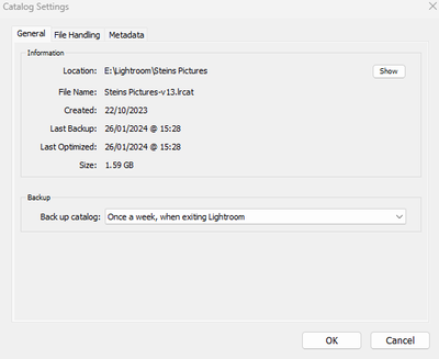

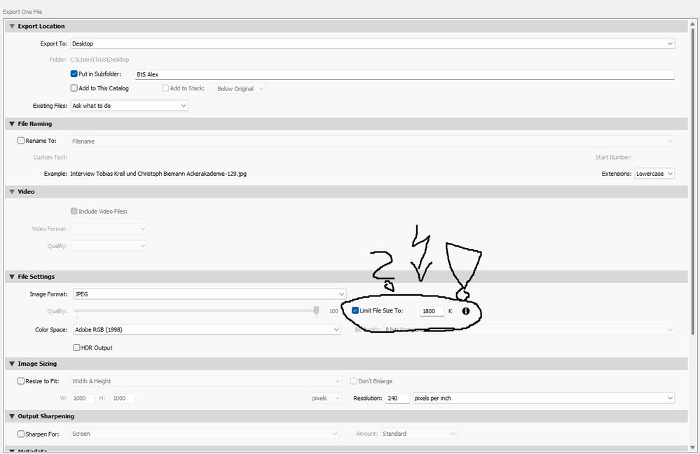

I have an Update, so the issue does seem to appear for me at least, when I downsize the images "limit size" within the export pannel, if I export without limiting the file size, it does relatively fine. @Albiemanmike is that the case for you as well?
Aside from that, it does seem that lightroom is putting a lot of pressure on my hardware when exporting, but not on my GPU, that might be normal?

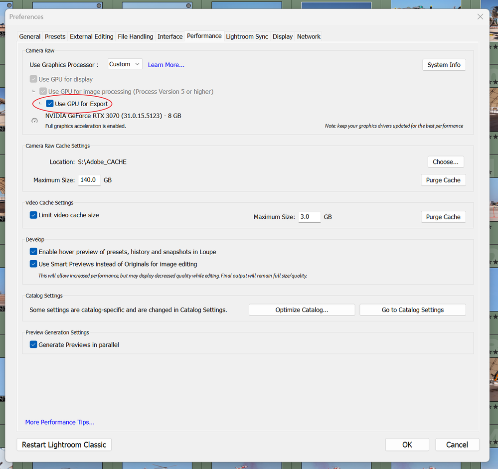

From your screenshots, I am wondering about this one
Is the NVIDIA RTX 2060 with 6 GB that old that it cannot support full acceleration, and is it not supporting export
Following are samples from my rig. Perhaps you can attempt to change the Use Graphics Processor setting from Auto, to Custom, and see if you can accomplish the following selections.
 As shown above, change to Custom. Very likely the USe GPU for display will already be checked. Highly likely the Use GPU for image processing, and the Use GPU for Export, will not be checked (yet), And the latter will be grayed out. Note that you will not be able to directly click on the last option USe GPU for Export just yet.

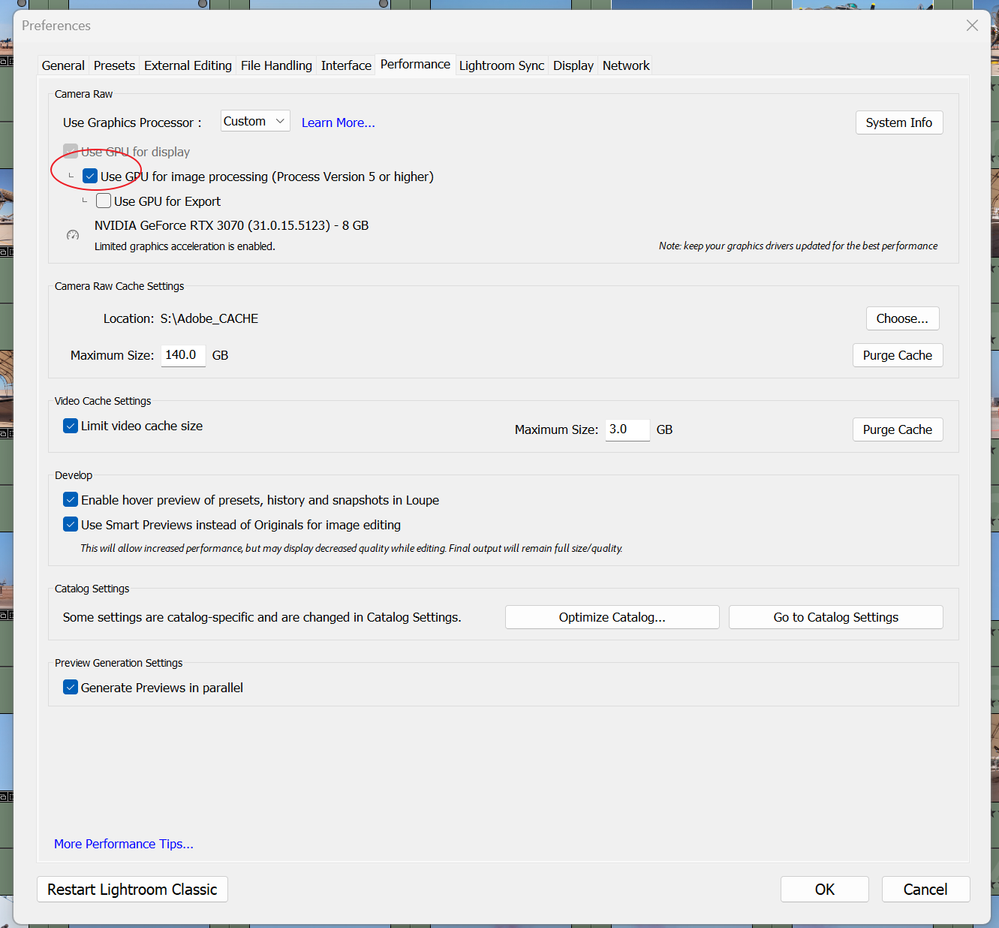

As shown in the above, check Use GPU for image processing
And, crossing fingers, click on that last one, Use GPU for Export.
I do not remember, if after clicking Ok, if you will need to restart LrC.
And I do not know, if after accomplishing the above, if reverting to Auto, would then behave better (if one wants to bother)

I noticed something yesterdays and that was, that the export is being heavily slowed down, if I downsize the images while exporting. If I don't select to resize, the time it takes is actually bearable.
Any idea how that might play into it?
