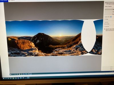

Hello, I would like to ask, why there is a problem with LR when merging HDR wide panoramas. Quite often it happens, that the midpoint of panorama is not in the middle of merged preview and final panorama is cut on one side, but continue on other side. See attached photo. How to merge it correctly? Am I doing something wrong?

Upload a problem set of originals to Dropbox or similar and post the sharing link here, and we can investigate.

Hi John, thansk for reply... I exported all raws to jpgs due to file size and are available here: https://we.tl/t-Mwnm8d0UP1
Just for information, preview panorama  is merged from raws, therefore it looks little different.

This is a known problem with the panorama merge function in Lightroom. That and that it often makes very bowed horizon lines. Due to the lack of controls, you can't do anything about it unfortunately. The problem here seems to be that the very bottom of the rightmost image overlaps slightly with the bottom of the very left most image and it therefore thinks it is a 360 degree panorama. For this sort of image you should use a dedicated panorama program because also Photoshop's panorama merge will have problems. I like hugin for panoramas such as this but unfortunately it hasn't been updated in years and doesn't run well on current versions of Mac OS X and Windows but there are many other panorama merge tools that give far better control than Lightroom.

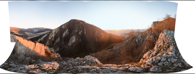

To build on that, here's the resulting panorama with left halves of the top-left and bottom-left photos cropped out, avoiding the false overlap detection with the right side of the panorama:
Using that as a workaround would be tedious, though, since Merge ignores previously applied crops.  So you'd have to crop and then export/reimport all the images as TIFFs and then merge those.
LR does much better than PS though -- here are its spherical and cylindrical merges:
(All of these tests were non-HDR merges, using the third photo of each bracket.)
